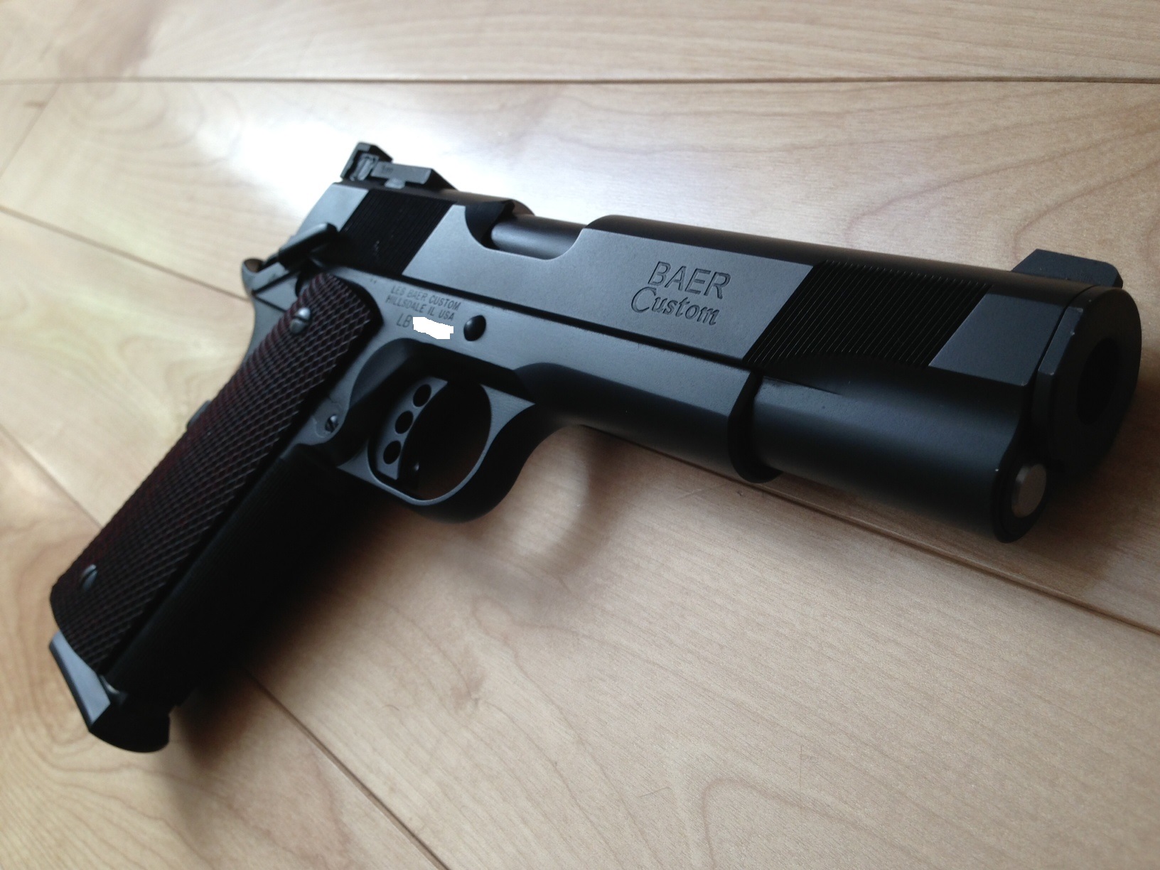

My Les Baer Prowler III is a bushingless 1911...
Very ###y looking gun "Harry" :) But your gun does actually have a "semi-bushing" around the barrel. The recoil rod happens to be flush
