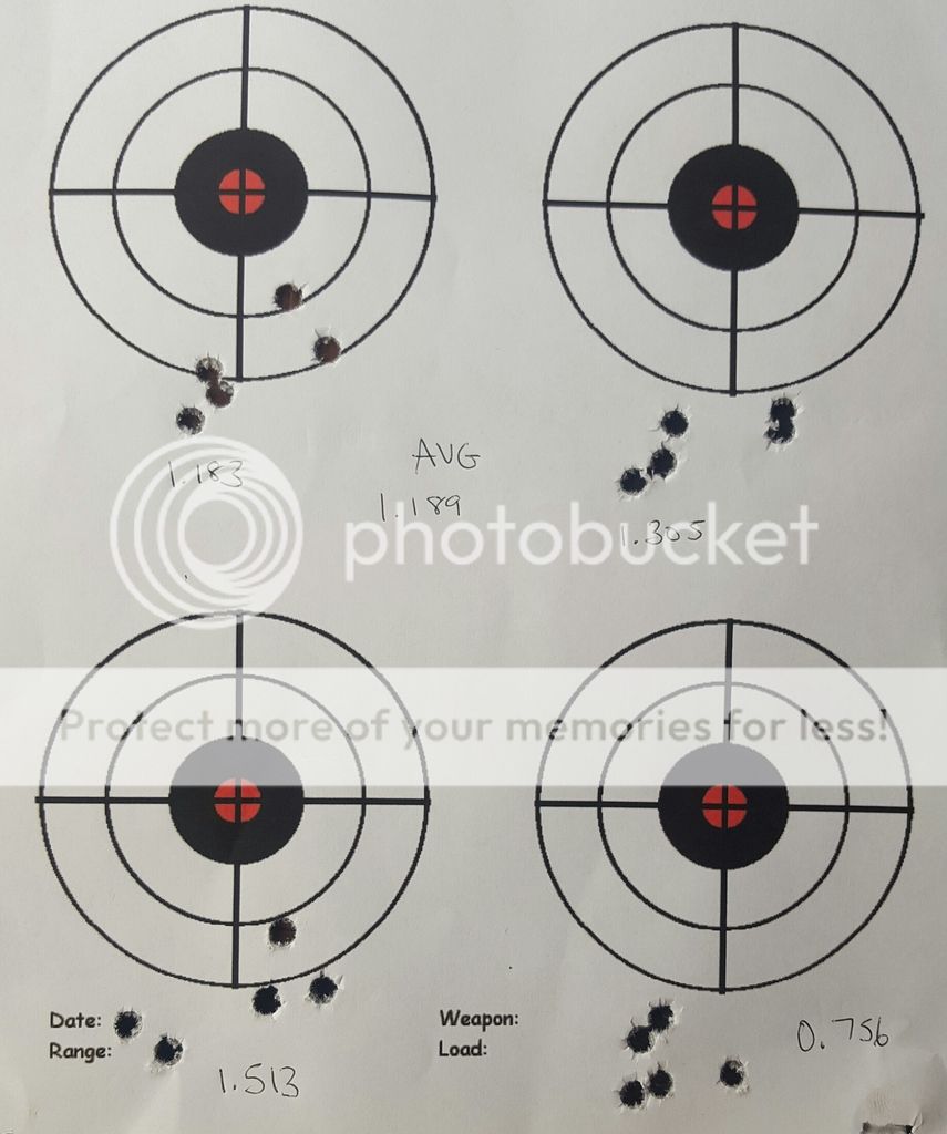

It was a little choppy out there today with this storm working its way in. Periods of very calm, then gusts of 40kmh. I have pics of all the groups if anyone really wants them. Although I just posted the best 2. Ignore how low I was hitting, if you all recall my first day out with it was at 155 yards. I zeroed it at that yardage that day and forgot that I needed to shoot a couple sighter shots to bring it back. But once I started shooting my groups I left it and fixed it at the end of the shoot. So here is 100 yards on the nose.

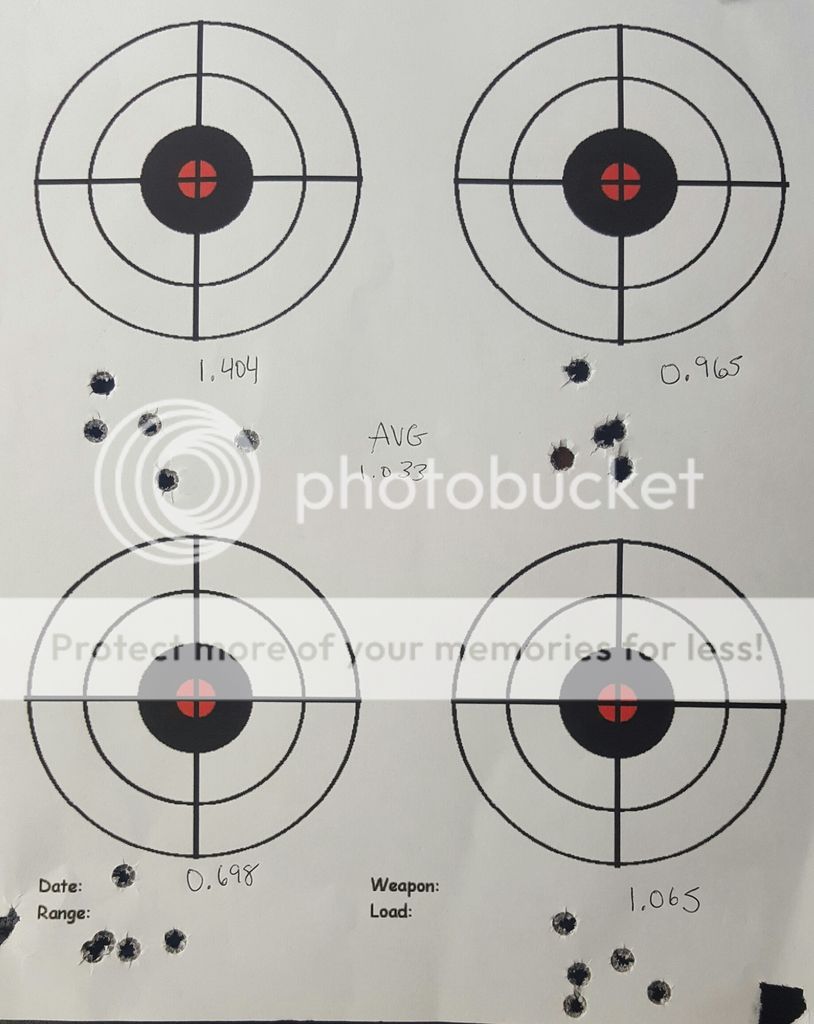

So I changed up my strategy. I got bored on Wednesday and bought some more reloading supplies, then of course spent all night loading it. I made 6 groups of 20. Here are the good, bad and ugly. Some may surprise you, as most thought the heavier bullets would do best. They for sure did not. Every group is 5 shots, 4 groups per page. Below is 4 group average.

And the group that surprised me the most. Both are notable
69 grain Sierra Match King - loaded 25.6 grains of Varget
69 grain Sierra Match King - loaded with 23.5 grains of 8208 XBR
So I don't see a major difference between the powders. But it for sure liked the 69 grain weight.
Considering the wind today I am super impressed with those results out of a semi.
