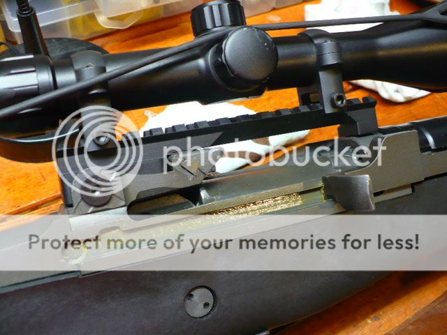

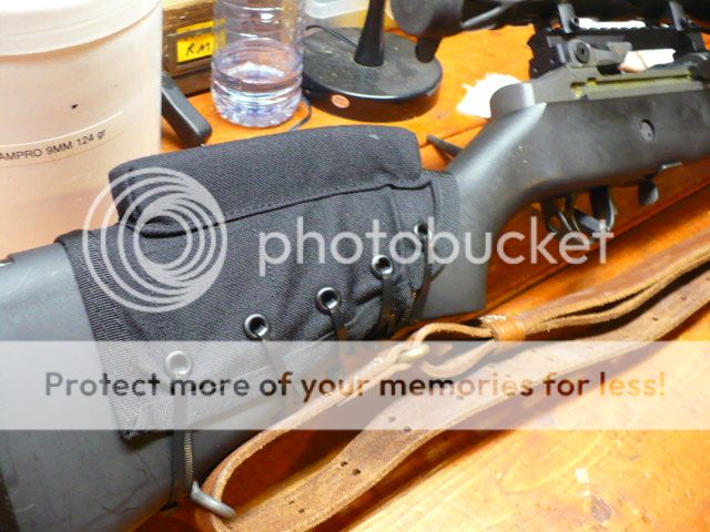

I have a 3-9x40 Bushnell Ultra HD on a CASM with 1" millet rings. Holds zero no problem. Eye relief can be a bit unforgiving at higher magnification so I did a homemade cheek riser.
My rifle has a CASM mount on it. I could have used lower rings if I had any at the time I installed it.
My cheekrest is a "Blackhawk!" rest that I bought off of Amazon for around $20. I used black zip-ties to attach it rather than the shoelace that it came with. I use the same type of cheek rest on my K31
