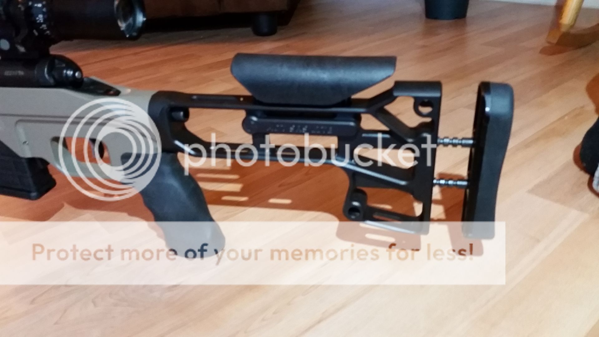

I have the Skeleton stock that MDT makes and it is comfortable and highly adjustable. It's a little heavy but you're probably not concerned with that with a precision rifle

The MDT Skeleton stock has a bit different geometry than many other stocks, the cheek rest is quite high even in the lowest position and max LOP is on the low side. But, it is a solid piece of work and adjustable.
Yeah I had to use a picatinny riser rail even with Vortex extra high rings paired with a TAC21. They should drop where the riser mounts to the stock about an inch to allow for proper cheek weld and scope mounting
I never had that problem with my TAC 21. Scope mounted with ATRS high rings and the scope bell sits about 6mm from the chassis. Cheek riser adjusted and it's all good.
I currently have a 50 mm scope in what I believe to be medium rings. They've been kicking around for ages. I don't have much room between my barrel and the objective lens. So little that my bikini scope covers can't fit. I like this set up since I'm not a long range shooter. Guess the mdt skeleton stock is out. It's looks so good though. Thanks for the replies so far
