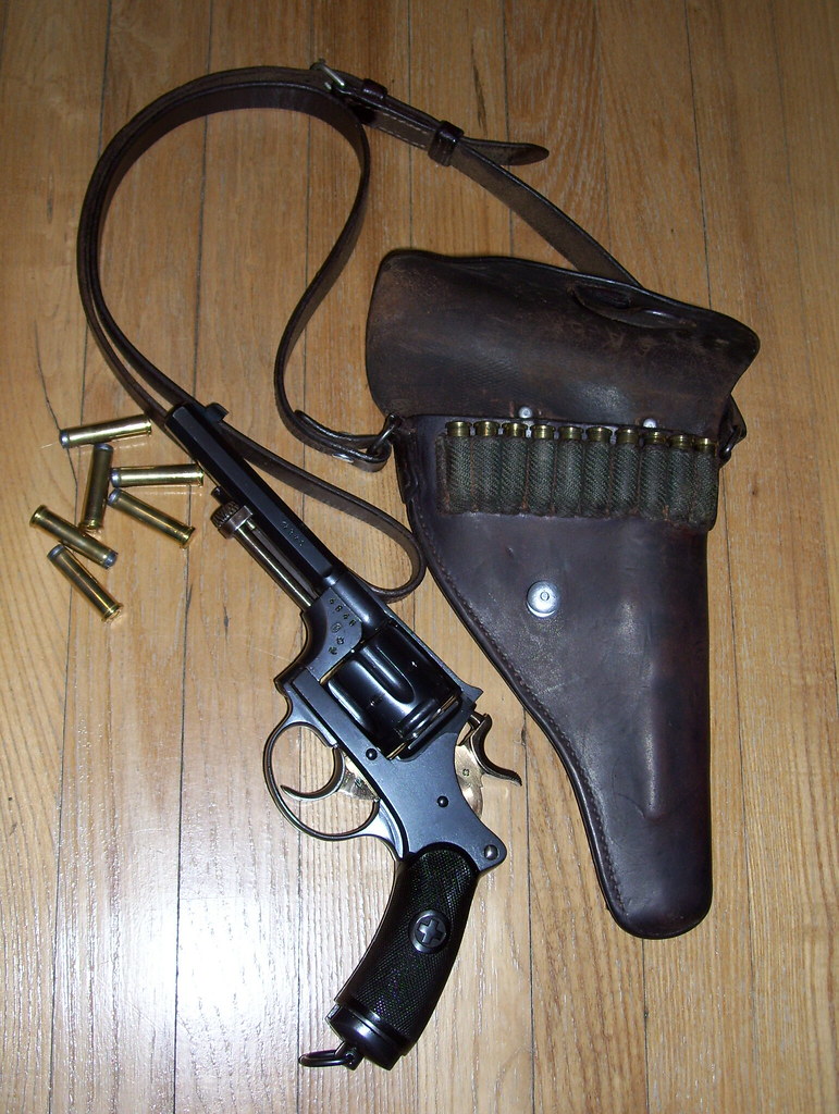

I also use 4227 in my Martini 32-20 Cadet (which also chambers "7.5mm Swiss Ordnance" and my various Swiss 1882 handloads).
I have an 1895 (production year) revolver with the "medium-strong" top strap, some of the earlier revolvers have a slightly thinner top strap, so what I provide, please take with extreme caution!
I get the BEST accuracy with between 2.8 and 3.3 grains of Trail Boss behind a deep seated .314" 100 grain H&N soft lead wadcutter in an untrimmed 32-20 Starline case resized in a 30 Carbine die. 2 to 3 inch groups at 15 yards is my average group size. I sometimes get tighter groups. Always fun outshooting the Glocks and other modern pistols.
I have "pushed the envelope" with up to 3.5 grains of TB, but noticed a very slight accuracy drop with the lead wadcutters. 3.5 grains of TB with a 100 grain wadcutter gives mid 900's fps. I can/would push my revolver to 1100 fps no problem, as I know the condition and capability of my revolver, but since they're not handing out awards of who can push the limits of the Swiss 1882, I choose to hot load for my Martini 32-20 (310) Cadet only.
Jethunter is now making 110-112 grain .314" bullets with gas check that would be great in our revolvers! I bought a batch of 200 from him, but have yet to fully test them. Once the winter is here, and I have less house maintenance, I will spend some time at the range testing them with various powder, brass (length and type), and primer combinations and report back.
Regarding 4227 again, I find that it really shines in my Martini 310 (32-20 reamed) Cadet fallingblock, which shoots factory 32-20 and all of my Swiss 1882 handloads, the later with supreme accuracy. The key with 4227 is a small rifle primer, even though performance with a small pistol primer is adequate (but dirty). I find that 4227 and a 100-112 grain gas-check bullet really sings at velocities over 1600 fps... and that is well outside of the 1882's "safety zone". I mark the rim of every +900 fps load intended for my Martini and ensure that the bullets are seated far enough out so that they cannot chamber in my Swiss 1882.
