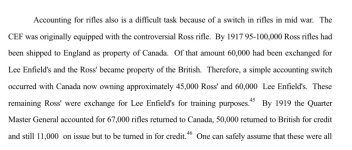

The CEF brought back 67,000 SMLEs from Britain that they had used in the war by 1919. A further 49,000 came by the end of 1921 which was all organised under the Imperial Ordnance Program (to which Australia also obtained 100,000 SMLEs to replace the rifles sent over during the war and left in the British system)

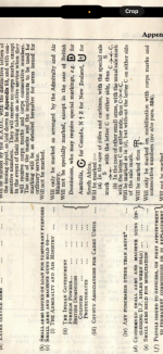

The British War Office did not want items stamped with the respective country ownership marking whilst in France as the agreement was that items on “loan” for the war would be handed back to British ordnance depots at the end of hostilities and the actual consignments of weapons to return to the countries under the imperial ordinance program, would be worked out via indents and requests once hostilities ceased.

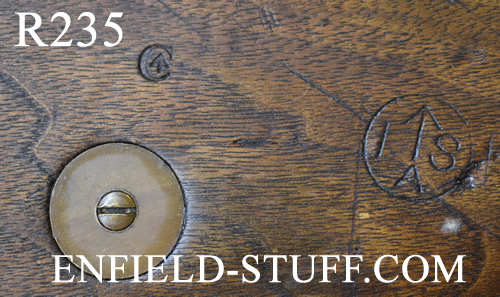

Hi Claven2. My preliminary assessment based on information received from this post is that there are 4 possible Canadian marked Service SMLEs used between the wars.
Type 1. C broad arrow stamp on the knox stamped there by the British with a British made die. Rifles used in war by Canadians then turned over to the Brits for inspection and refurb/repair. The British die has a broad arrow in the C
that doesnt touch the C (2 pics attached). The rifles then are crated and are sent to Canada either with or without
Canadian troops on board returning from war. Rifles go to Canadian storage.
Type 2. C broad arrow stamp on the knox that is stamped with a Canadian die in Canada. The die has the broad arrow with all 3 arms touching the inside of the C (pic attached). Rifles are a further Brit alotment ending 1921 (approx). I can prove
that the same style of Canadian die was domestically used in 1912 on rifles and again starting 1922 when the .22
Martinis started to arrive from BSA to augment the Ross .22.
Type 3. Canadian Navy received SMLE rifles probably from the British Navy as Canadian Navy rifles have no C broad arrow at all but instead stamped with C broad arrow N. Example in pic shows body and knox stamped. Somehow Canadian Ordnance stores were bypassed. Pic attached. Since I had my camera out:
In addiion I added a pic an arsenal repair job of a handguard done as a precaution against splits. Notice the reinforces are
narrow and at an angle. Pattern B flat rivots are used too. Pattern B handguards have reinforces at 90degrees with flat rivots.
