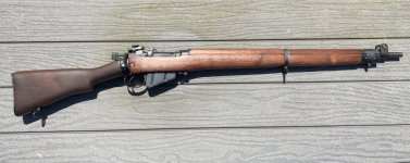

I’ve been slowly putting parts together for a build. Still missing a few parts. Rear and front sight, bolt and proper barrel. Looking at lining a No. 4 barrel. Mag was the most expensive $100. Stripped action $40. Rest of parts I picked up while buying other parts so fairly cheap. The biggest thing I find building some of the less common Lee Enfield’s is finding correct parts. My OL parts took 2 years to find. Getting close to 3 years for the C 7.
A clean LB walnut stock set with grooved handguard would be needed. Good stock sets are a lot less common than they were.
The front sight base is unique to the No. 7, there being no lugs on the barrel. A lined .303 barrel works, but is obviously a substitute.
Center swivel. Every .22 I've seen had a stamped trigger guard and pressed steel buttplate, typical of late production.
Barrels are extremely rare.
Don't recall seeing a No. 7 bolt for sale. If one turned up, I'd be inclined to number the receiver to match.
The receiver is one of the easy parts, although not as common as they once were. I recall hearing that some 400 of the refurbished ones were released.
While waiting for a proper rear sight assembly, a PH5C or AJP rear sight works just fine, and gives fine adjustments.
You would think finding a shot out No. 4 barrel would be easy, it’s not. The liner and drill bit is easy. Lately I have been finding excellent No 4 barrels which have been going on actions. Original forestocks it’s been over a year since I found any. Original NOS butts and hand guards I have multiple in different colours. Always seems to be 1 or 2 parts that are hard to find.
I’ve already thought of using one of my PH5’s as I have multiple or my Central No. 4. I’ve put rifles together before with miss matched parts until the proper part has shown up. The parts missing are forestock, barrel , sights and firing pin pieces. Parts will show up eventually.
