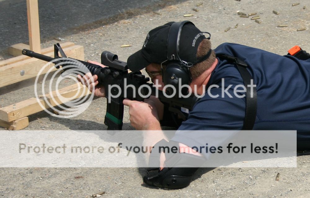

Dave, I have seen a number of CC C8's with M4 profile barrels in the hands of LE Officers ...I have a few pics of a Donut eater buddy wielding one on a course...will dig it out ...

The original C8A2 picture is of a LE sale or Dutch or Danish C8.
It is not a M4 contour barrel.
One of our LE members here that I took a pic of his carbine at a course.
Versus the C8SFW barrel
