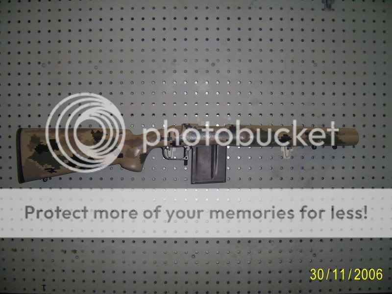

Considering a paint job on one of my rifle stocks, anyone do a CADPAT pattern? Photos and suggestions greatly appreciated. been searching the web without too much luck.
This is my 1st digital paint job.
I got my supplies from Barret Arms, also got lots of info from Barret. (Murdoc)
Great guy to deal with.
I have a rem synthetic short action that I picked up pretty cheap on ebay, a good one to start on, think I'll get rid of the checkering and widen the forend with some fibreglass. Looks like it'll be another coyote gun.

Make you own.Thats what I did.
Allthough it is time consuming.
I used overhead projector film and traced the patterns from actual CADPAT.The film can be cleaned with laquer thinner and be re-used MANY times.

This is the Late Ron March's rifle that I did for him just before he passed away.
