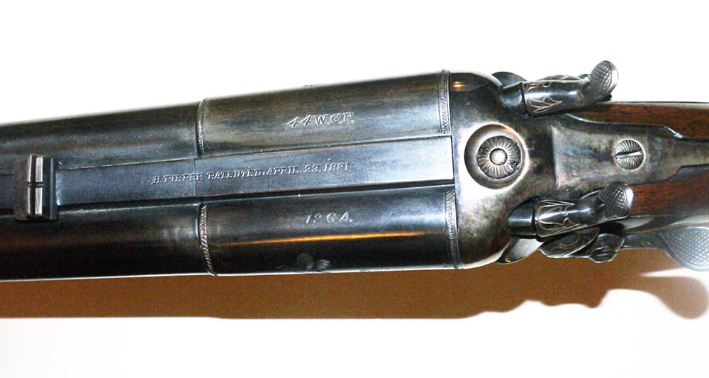

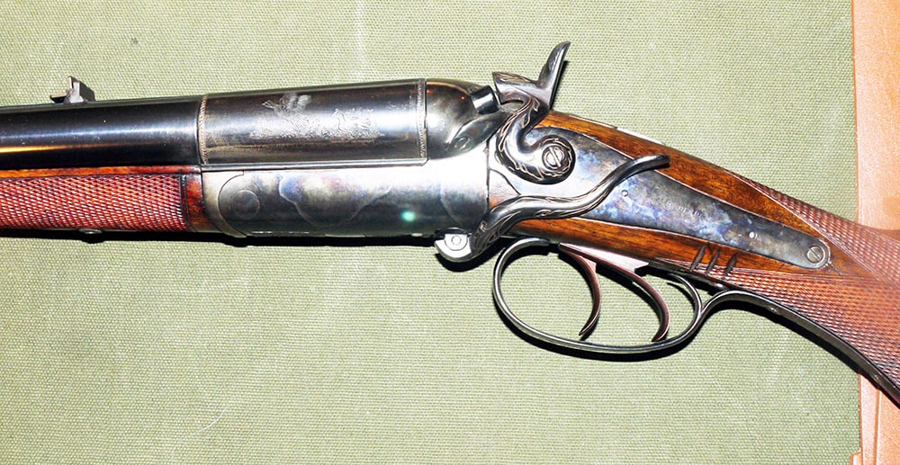

I know !!! My measurements are somewhat suspect . Amateur job w the tools available to me . Basement wax chamber cast Blah blah . Case appears rimmed and fairly straight taper although a slight shoulder before the neck . OAL could be way out as I might have cast some of the bore . Any speculation as to cartridge info would be appreciated . A 38/55 falls into the chamber and the 38/55 bullet at the muzzle is sloppy in spite of my vernier .35-.36 reading . Still pouring through my Cartridges of the world book lol but thought I would try here as well . She is an H. Pieper rifle /12 . Pat date April 1881 Belgium .
Hope the pics are clear enuff . Thx for any input .

Then it's likely not a 360 for sure, when I bought mine it was actually registered as a 38-55...very similar. If the 38-55 dissappears, you are likely a luckier person for it... 9.3 x 72R is likely a much more common caliber.

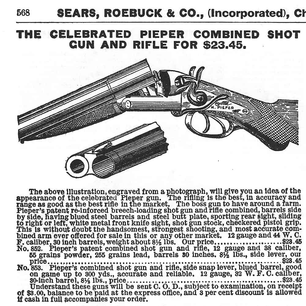

It may actually be .38x55 after all if it is one of their North America market combination guns sold by Sears, I found this picture from a old Sears mail order catalogue, they sold a fair number in North America and also made them for the European market in European cartridges -
