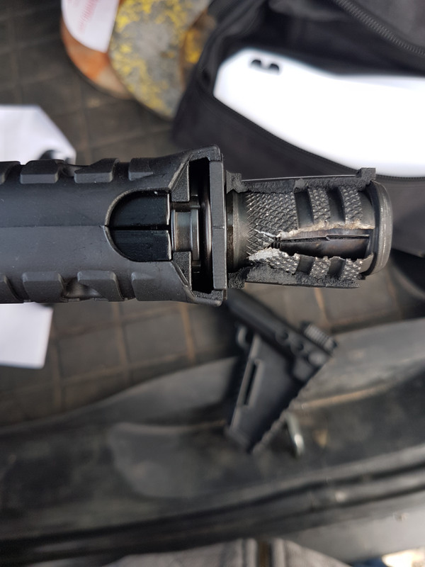

Kel-Tec is not a quality brand, I would be inclined to agree that the gun should be babied. I have worn out two 9mm S2K and I had a .40sw model that only lasted 4 rounds before it blew up in my face. Junk...
