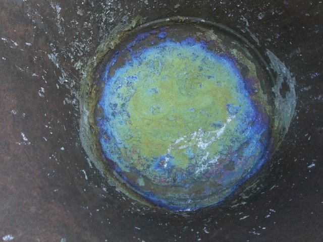

This is how my big melting pot looked the next day after overheating it a lot and melting in zinc wheelweights during my first ingot making adventure.
Ended up selling the ingots to a scrap metal place and got a good price for them so all good in the end lol.
Had gotten a pid controller and had a hard time getting the pot at the right temperature, turned out the thing was set to celcius instead of Fahrenheit :)
the blue and purple colours were really bright and pretty.
