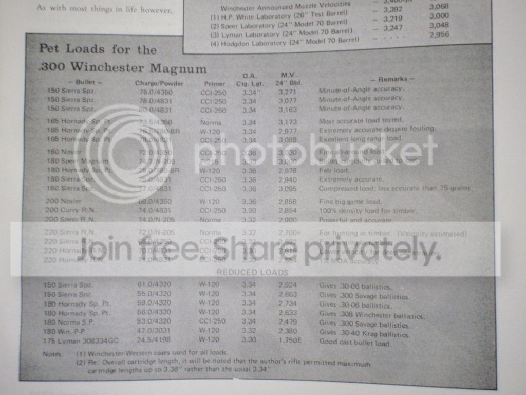

I've loaded my 300 Win. Mag. down to 308 speeds with lighter bullets. Re15 worked well for me and required less than 60grs. I used the data in Speer Reloading Manual No.12 as a guide.
Yes, easy to down load the 300Win Mag down to a 308 velocity.
Just use the Start load in your manual for your usual powder. That will give you 308 max velocity.

For a number of years, I loaded both the 300 Win Mag and the 308 Norma Mag with the same reduced load, as follows.
CCI 200 Primer, 180 grain bullet [your choice of cup and core bullet] 50 grains of IMR 3031.
In several rifles, this produced around 2600 fps velocity, and most shot very well with it. One 308 Norma was consistently sub moa.
IMR or H 4895 will yield similar results. Dave.

I developed two light (.308 ) loads for my .300 wm. (1 ) 70 g IMR 4350 CCI mag Primer 150 gr sierria nice load for white tails out to 250 yds
2) 58.5 gr. IMR 4064 CCI mag primer 150 gr. Hornady SST vel . 2775 fps out of my short bbl 300.Unbelievable accuracy.
