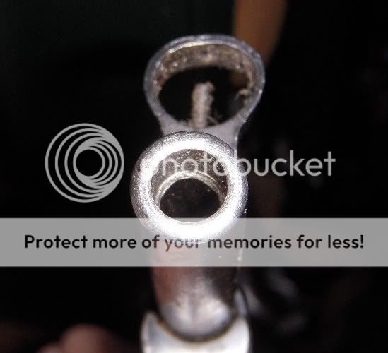

Can you post the pictures of the bore in excellent condition on Mosin Nagant rifle?

Please. I'm fairly new to surplus market and description of the bore's condition is usually "excellent" which can be confusing to the people with less experience. I'm aware about the bullet test performed on the muzzle, but has little idea about how a very nice bore on the Mosins should look like. Thanks in advance for your help.
If its shiny and has continuous well defined lands and grooves. Its excellent. If there's pitting in the grooves and none on lands, should be good.
If pitting on lands and grooves then its poor. Shinier the bore the better it is.
Unfortunately there is no definite answer. It comes from experience of looking at various bores and coming up with guesstimate.
I would rate your mosin's bore as excellent.
