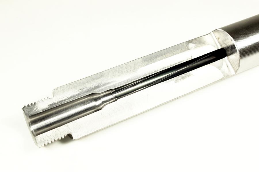

Here is a cut away image of a 223 Wylde chamber and bore on our 5R series of barrels. This was just a scrap end cut we thought we would chamber to show you all what you can expect from a Maple Ridge Armoury 5R barrel.
Despite the lighting, the chamber is extremely smooth to touch, there are no machining marks. The bore as you can see has been hand lapped thus producing a perfectly smooth finish.
