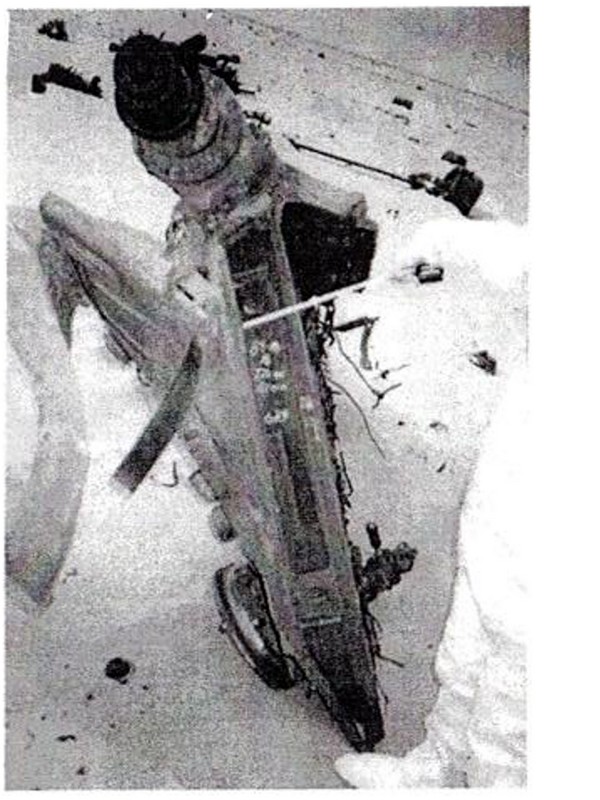

Damage caused to the T72 by the various trial rounds, not allowed to take pictures and even the manufactures where not allowed to see their competitors strikes/damage. They could look at and take pics of there own but not each others. To be honest the 105mm ammo jazzed up to hit like a 120mm was a dead dog in my books. The target tank had all the "soft" parts cut off like search lights/grenade launchers/hand rails, essentially anything that would contaminate a clear hit on either turret or hull armour. The thought was the rounds would go sailing clean through, but the first round was a sobering wake up that maybe the Czechs/Russians knew a thing or to about building tanks and casting armour. The first round struck just to the left (as your looking at the tank) of the main gun, and just got absorbed by the turret armour. We popped the turret hatch open expecting to see a penetration and all the damn thing did was form a slight plate sized bulge in the armour and cast some paint flakes around of the turret wall. The test rounds faired "slightly" better on the hull front armour (this being a M1 Standard production tank it had a 20mm plate welded to the glacis plate and with the glacis being so sharp it did a good job at defeating the 105/120 rounds)but still even half failed to go through. One got in and started a small fire inside so yours truly went inside the burning tank to deal with that. Talking about fires the fire bottles on the T72 came filled with Freon gas and that's a big no in N.America reading the book it talked about the explosive squibs used to fire the bottles but no pics of it so rummaging about the "pile of "stuff" I found spares of what I assumed where the squibs just rolling around loose. Health and safety hah, who needs that.

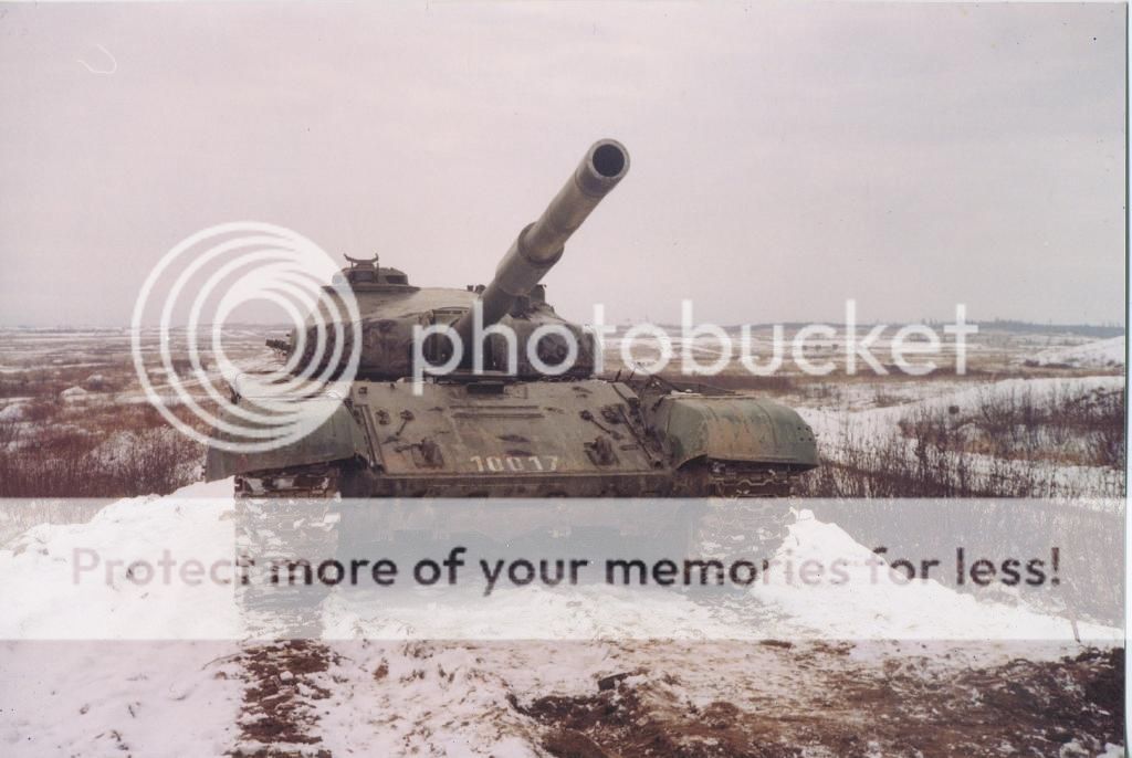

^This T72 was the first to be shot at in Canada during the Leopard Mid Life Extension trial (again why the liberal government did not drop the coin on the Dutch Leo II is crazy, spend a dollar to save a dime logic).

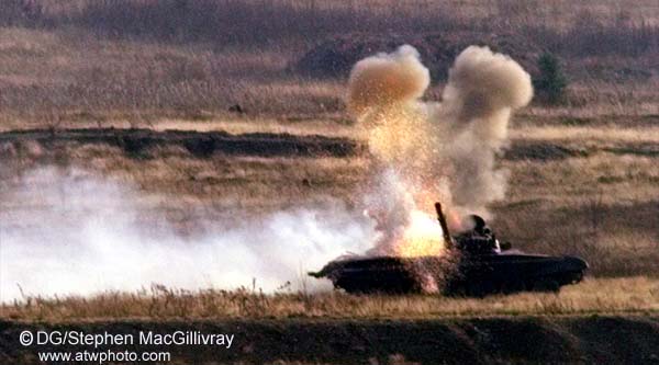

Anyways as you can see anything that could contaminate a clean projectile on target armour has been torched off. I can tell you from being there and being the first Canadian to ever shoot a T72 the tanks armour is VERY capable. Two days after the picture the shooting started and after the trials Range Control Gagetown was given it by Trials and Evaluations as a range hard target and it became a favourite target for tank gunner course to shoot at.
It was kind of sad to see the tanks get shot up but that's why they where brought to Canada so they served there purpose. Many people go on that they where brought from Germany for some sort of mini Ops4 but that was really just a bonus/secondary thing and never the reason they where here.

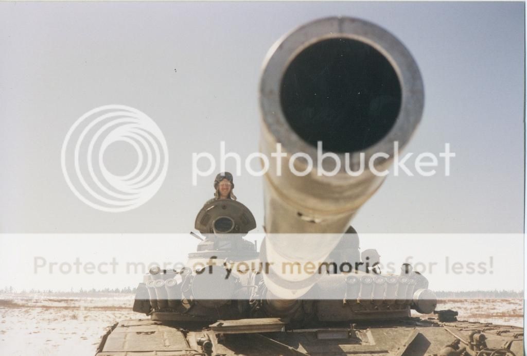

One of the rewarding things of being in the field with the T72 was the amazing degree of latitude we where given as the things where just so weird to see driving and being used as an enemy force till T&E needed to shoot something at them (like the Leopard Mid Life Extension)120mm to 105mm, ADATS, TOW2B, etc. C Sqn RCD took great pleasure in seeing them and it was not uncommon to be tracked by Leopards WAY, WAY out of any conceivable arc. Tank gunners did love tracking us to say the least. The thing was everyone said that the 125mm muzzle end was very visible even at 2,000 M and it was sobering to think if they where looking down the pipe then the T72 gun was also looking back at them and if you ever see the 125mm AP round or HEAT round I have great confidence it would have ripped through the Leo C1
