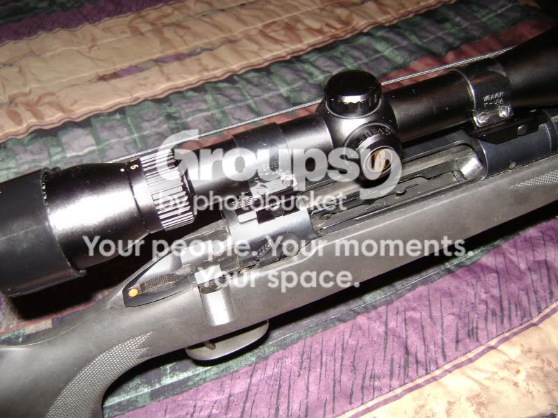

Yes when i switch the scope i switched the rings. I just bought what was available to me at the time. 1" weaver rings.

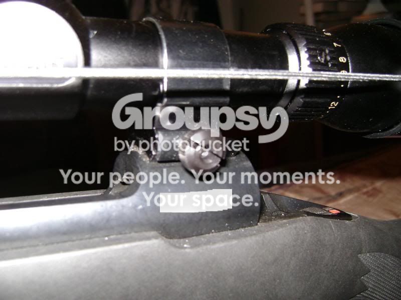

Is the rear base of the type, such as a Leupold STD model, that has two large screws that grab the rear ring from either side? Those are for coarse windage adjustment, and might be way over to one side.
They work now...
Those are typical Weaver bases. Just make sure everything is good and tight, then try bore sighting by looking down the barrel at 20 or so yards and lining up the reticle. If you still run out of adjustment range, you may have a bad scope that has the reticle installed off centre to the erector assembly.
That is an interesting front base. Can you post a couple more of the front mount.
It's a standard Weaver base with an extension ring on the front that accommodates mounting a scope with a short tube; I also find that Savage long actions need these with almost any scope and a Weaver setup.
