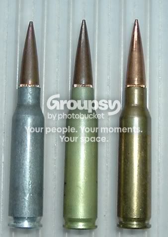

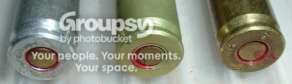

These little darlings have a caliber of 5.56mm and a case length somewhat less than the standard 45mm. The headstamped round reads 'F A 7 3'
Case materials from left to right:
Plain aluminum, anodized aluminum and brass.
I'm looking for the name of the program these rounds were developed under.

Good guess. It is the right time frame, but the SAW program was centered almost entirely around a 6mm round. Not to say that there wasn't overlap in technology (that will come in a further post), but these rounds are not part of the SAW program. The key to this quiz is the projectile.

FABRL Von Karman Bullets?
Perfect!
FABRL = Future Ammunition for Burst Rifle Launch.
This was a Frankford Arsenal program that ran from 1971-73 to study high L/D ratio projectiles with very low weight. There were a large number of projectiles whose designed centered around a composite cored bullet (steel, plastic, epoxy, tungsten, uranium, aluminum) with a weight of around 37 grains and a muzzle velocity of ca. 3,800 fps. Because of the ballistic efficiency a smaller powder charge can be used, and thus the shorter 38mm case.

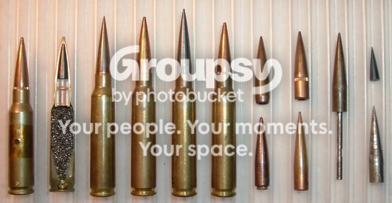

This picture shows some of the variations produced:
From left to right:
5.56 x 38 Pressure Test

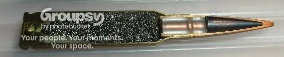

5.56 x 38 Sectioned showing a typical AR-2 projectile with a steel and plastic core. Within the case is a silicone insert called an FIE (Flexible Internal Element). This was a feature used in the development of the aluminum case to prevent burn-through – and was also used in the 6 x 49 aluminum cased SAW round.
The next 4 rounds are in 5.56 x 45 and predate the 38mm case rounds. These are ballistic test rounds that were single loaded when fired because they will not fit in an AR magazine like the 38mm case round will. Also featured are some projectiles of different designs. Of particular note is the frangible projectile formed around a steel rod. The rod has not yet been trimmed.
