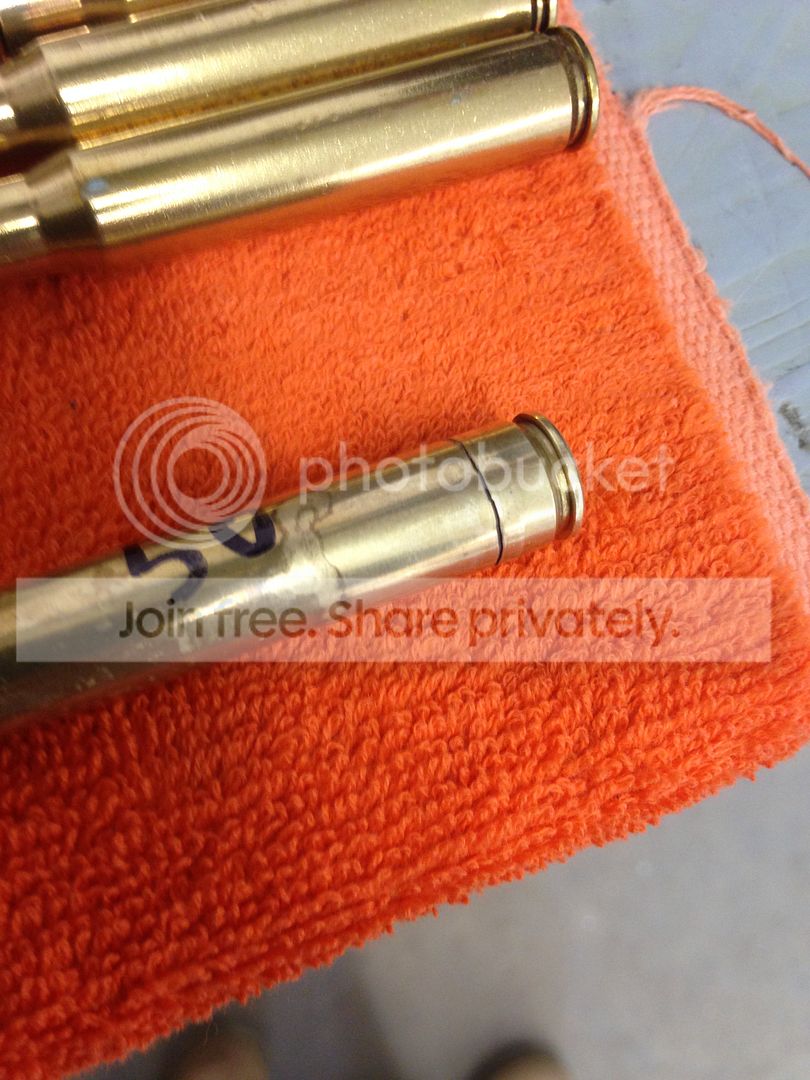

Case head separation - first time/w-photo-MORE PHOTOS
Could be a fluke but more likely you have a fairly loose chamber and are full length resizing. This can happen even with relatively mild loads. To prevent this, only size cases until the shoulder is pushed back a thousandth of an inch or two. This can be measured with a stoney point head and shoulders gauge ( now sold by Hornady) and a good caliper. Measure a few fired cases to determine the length to the datum line of the shoulder, calculate the average length and set your die to push back only the minimum 0.001 - 0.002". No more problems and longer case life too!.
Another thing you can do is color the neck and shoulder of the case with a permanent marker, then starting with the die well above the shell holder, you can see how much of the case is being resized as you gradually turn the die into the press. If you begin by adjusting a quarter turn at a time, there is no need to proceed further than the case neck, if the resized case chambers easily in your rifle. If it takes effort to push down the bolt handle, return the brass to the press, and incrementally turn down the die an eighth of a turn at a time, until the brass chambers effortlessly. Once its there, lockdown the die, and resize the rest of your brass. If you note how high the die sits above the shell holder, you'll have a reference for where the die should be set. I dislike the lock screws on the die rings, preferring to set the die up each time I resize, then put a wrench on the lock ring to ensure it doesn't move until I'm finished.

Case separation will eventually happen with out of speck headspacing and or overcharging. I pushed these cases hard.
