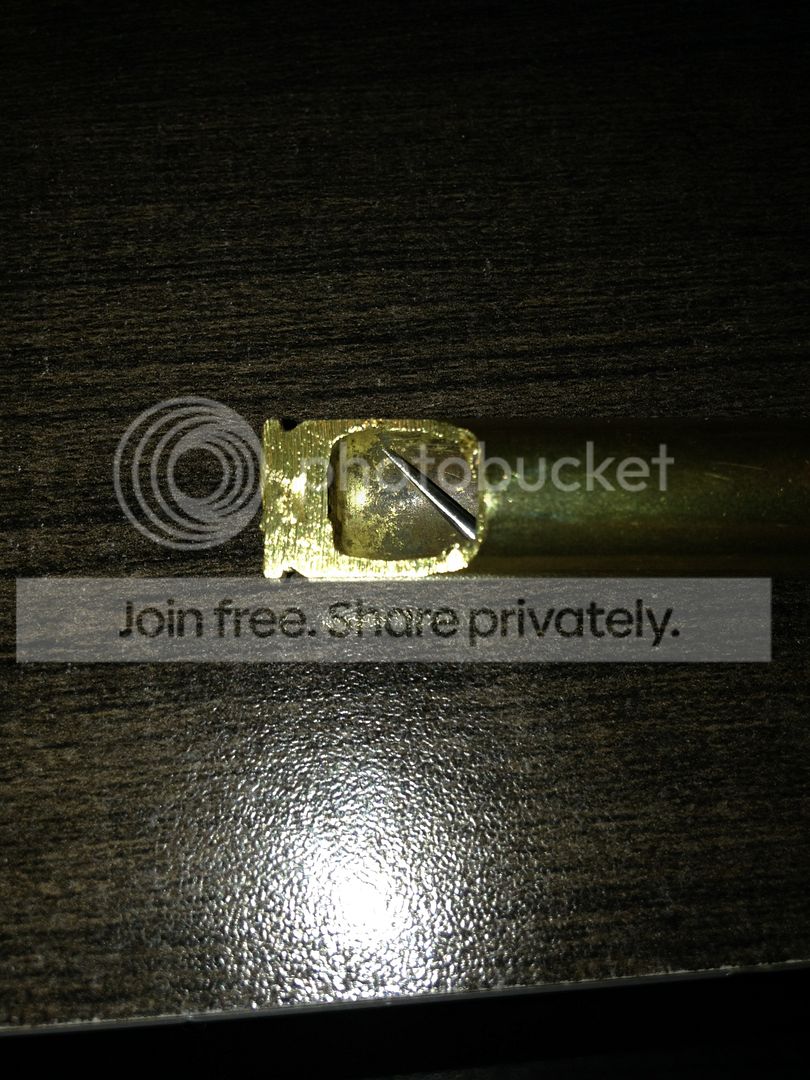

Case head separation - first time/w-photo-MORE PHOTOS
Take some of your other fired cases and section the heads. You don't need to cut the whole case, just the last 3/4".
See if any are showing an incipient separation like the one in GMC403's excellent photo.
Your case, and GMC403's are classic examples of case failures resulting from an excess headspace condition.

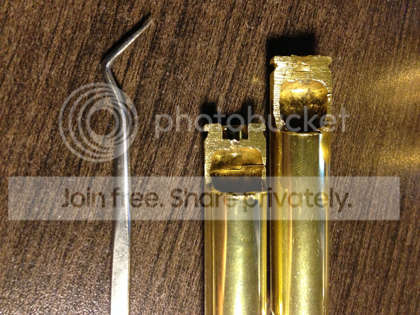

Straighten a paperclip and then bend an end at 90º, the bent side long enough to fit the case mouth
Drag the bent end inside of the case to feel for any thinning near the case head.
Such thinning is a sign of imminent case separation.
Cool, thanks!
Here is the internal of the failed case and another that I felt a spot where it may/will fail, the photo doesn't show the area of thinning as well as the naked eye but it is there and you can feel it.
Can't say I care for that inconsistent wall thickness either.
Looks like I will be going through all my "1F" brass from the EE. :rolleyes: Or toss and just go new.
