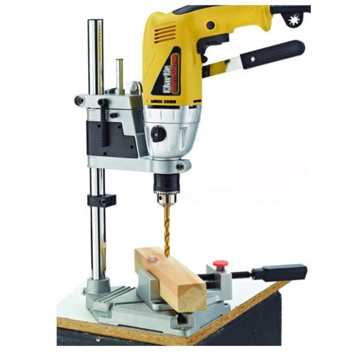

How about using one of these to convert your hand-drill into a drill press? These seem to be about $50 +/-.
I don't have a drill press.. Yet. Not sure I have room for one in my shop but eventually I'll get my hands on one. As for trimmers I'm leaning toward the Forster unit, as I've heard nothing but good things about them. Although the Lyman and Hornady seem just as good and a little more readily available. Has anyone had any performance related issues with any of the three? I see I can get the Lyman universal unit with the carbide cutter and nine pilots for $142 plus tax, free shipping on Amazon.
