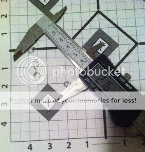

Three of these are match targets, shot at Spruce Grove and Trochu, all are 200 yds.
These were breech seated 209grPB from a Jones mould, about 1450fps out of a Browning 1885 with an RKS 32-40win barrel. 13.5gr AA9, Emmerts lube.
There are better targets than these around, and better shots than me. Cast bullets can deliver some pretty good accuracy when breech seated. the 25 is 1-1/2". I have seen .969 shot with the same bullet, 10 shots, 200 yds.
I have some 100yd targets from a weekend winter match shot with a 32-30rem somewhere, can't find it at the moment. But, these illustrate the point that they can be accurate.
