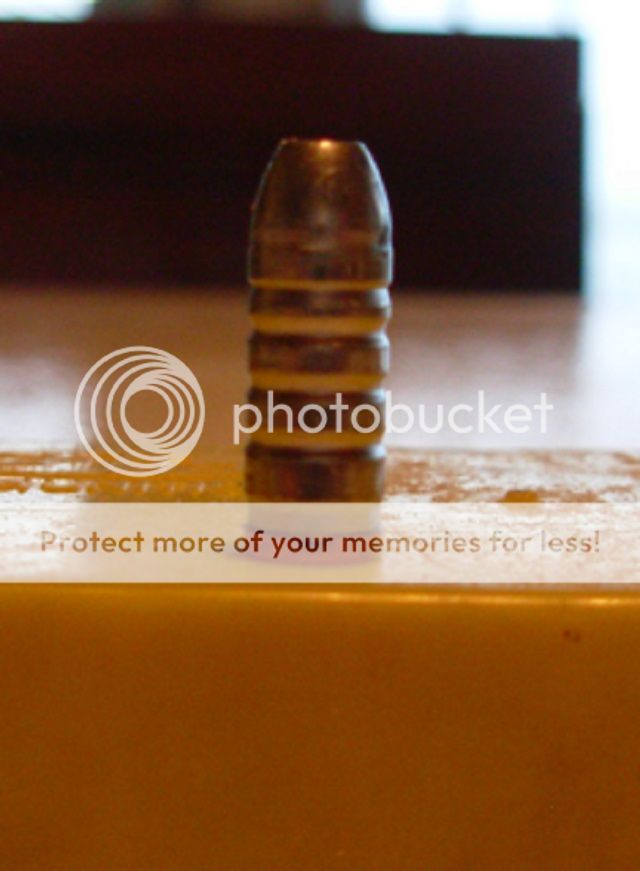

Here are the boolits, cast from lead picked up at indoor range, mostly .22 and lead pistol boolits, don't know hardness but will eventually measure it. It's pretty soft.

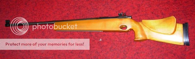

Iron Sights
Savage 1899 .303 Savage, (year 1916) with Marbles tang peep sight. 26" barrel 1:12", slugged .302"-.308"
http://s1093.photobucket.com/user/nilsek/media/CB-target/b1899_setup_zps23236945.jpg.html?sort=9&o=1
View from the shooting bench: no sky makes for a boring view, and if your trajectory isn't flat enough, 200 yards is off limits.

Boolit used for this test: Lyman 311467 (185gr), Lee Aloxed and sized/gas-checked to .309"

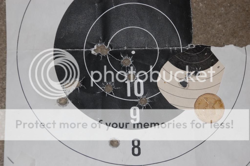

10 shots at 100 yards (10 minute relay)
http://s1093.photobucket.com/user/nilsek/media/CB-target/e1899303Savage_100yds_20141114_zps9cf4d97c.jpg.html?sort=9&o=4
Spread: 4.75"
6 shots completely inside 1.75" circle
http://s1093.photobucket.com/user/nilsek/media/CB-target/f1899303Savage_100yds_20141114_remarks_zpsc4f9046e.jpg.html?sort=9&o=5
I realized after finishing that the peep-sight aperture eyepiece had shaken loose! So I could blame the flyers on that, except that my last shots were the ones with the tightest grouping !!

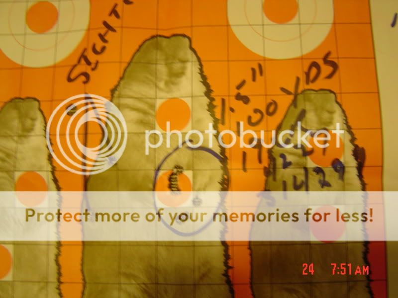

http://s1093.photobucket.com/user/nilsek/media/CB-target/iSav99300Savage_100yds_20141114_zps4bd1ac39.jpg.html?sort=9&o=8
Spread: 3.125"
9 shots completely inside 2.25" circle
http://s1093.photobucket.com/user/nilsek/media/CB-target/jSav99300Savage_100yds_20141114_remarks_zps764a7499.jpg.html?sort=9&o=9
