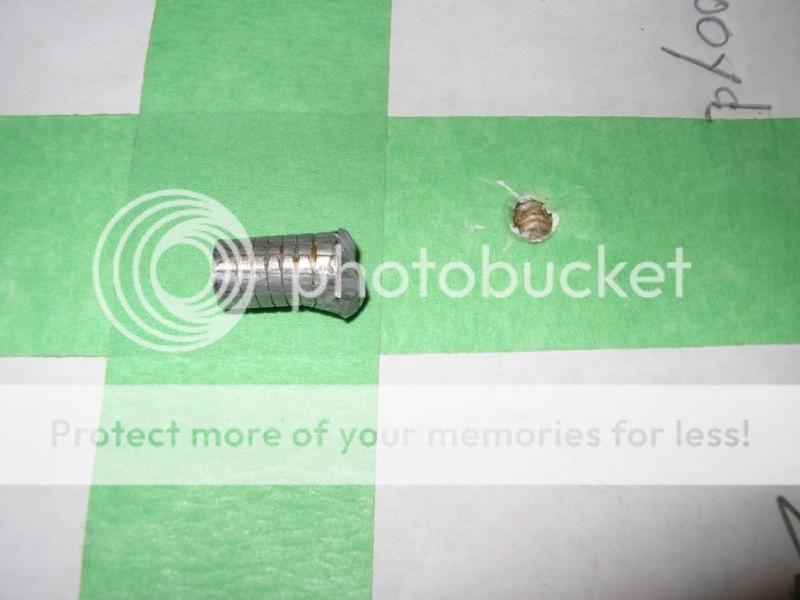

Posted this in the cast bullet #### thread quite a while ago. How's this for a hunting load? Northman 285 gr plain base straight wheelweight metal at over 2200 fps muzzle velocity has worked very well for me in the 9.3X62.

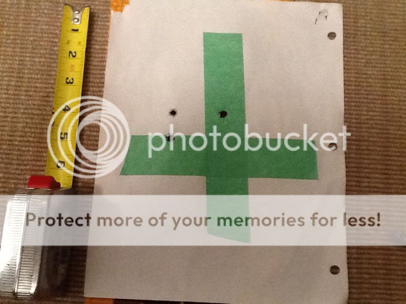

The loads feature a wad of half-inch square of old cotton towel tamped down over the powder and under a Cream of Wheat filler. The wad protects the COW filler from powder gases, the COW filler protects the base of bullet, and scours the bore clean with every shot. No leading, absolutely none, and groups are consistently two inches at 100 yards.
This bullet penetrated six four-litre jugs, and was caught in the seventh in water test. That's over 36" of water and about an eighth of an inch of plastic!
You can see how cleanly the bullet is engraved by the rifling, and that the base of the bullet has not fused at all. Will have to check my notes to give you the retained weight of the expanded bullet. Just checked, and the bullet pictured weighs 204 gr, a bit over 70%, and is expanded to almost 45 caliber.
There was no unburned powder in bore or on the snow, and best of all, no leading! One patch of bore solvent, and one of KROIL, and it is ready to go again!
