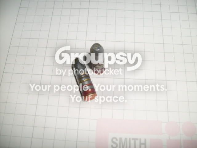

Well, today I am home sick but not sick enough to hold me down!
I had cast some 170grn Lee FP bullets awhile ago, just today I figured out a way to lube them (melted bullet lube/wax, dipped GC'd bullet and then it through the lee sizer) and my first load was really good.
On my measured 100 yard range I got 3" 5 shot groups out of my 20" model 94 and 2" 5 shot groups from my 16" Trapper. thats better then I can do with factory ammo!
Velocities I was blasting at were ~2030 from the trapper, and ~2125 from the 20" barrel. Best of all, is both my sights are dead on now too!
I didn't notice any leading, but I only fired about 20 shots through each gun, how many rounds is normal before you see leading from a bad load?
When I first fired these through the chrono I thought I was way to hot and would have leading for sure.... but it seems ok, still nice shiny bores with lube traces on the muzzle right after shooting.
All in all, Unless I cast a ton, these weren't any cheaper then just buying bullets, but it is something fun to do. I know now if I can't buy projectiles anymore I can atleast make em :)
