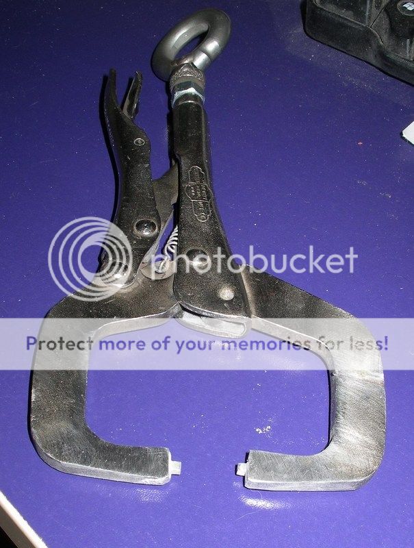

I took out the set screw, and the castle nut as expected is stuck on tight, wont' move. I don't have the castle nut pliers, so I'm interested in hearing what other options there are. So far I've found (hammer and punch method, hot/cold method, soak with Kroil/Liquid Wrench, needle nose pliers).
