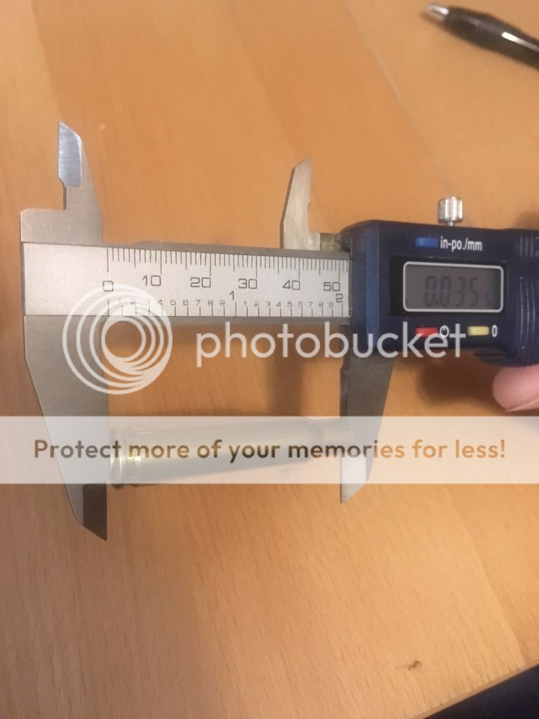

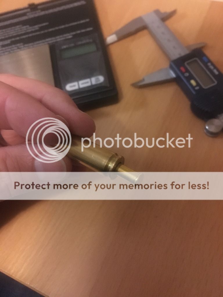

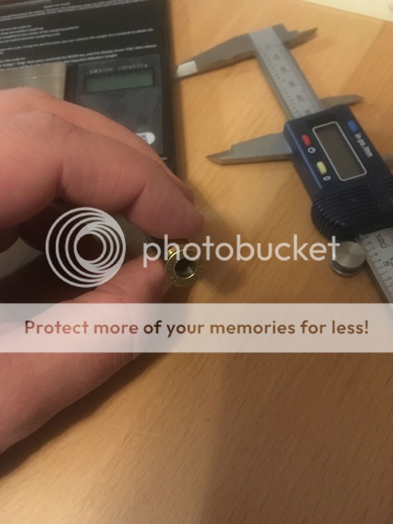

I made a rim sizing tool by drilling a 1/4" hole in a .308 shell and using it in a caliper.
I started with the golden bullets. Rim thickness varied from 28 thou to 39 thou. There was a slightly higher number of rounds that were 32 thou, but most were evenly spread across the board. Weights ranged from 51 grains to 52.7 grains. That about what I expected from bulk ammo.
I tried the minimags next, and was very impressed. Rim thickness varied from 36 thou to just 36.5 thou... for the whole box of 100! Weights were equally impressive. Out of 100 rounds, 53 weighed in at 47.7gr, 43 weighed in at 47.8gr, and the remainder weighed in at 47.6. Very impressed.
I don't know what a similar inspection of match ammo would look like, but the consistency of those minimags
Blew me away. Worth the few bucks more I'd recon.

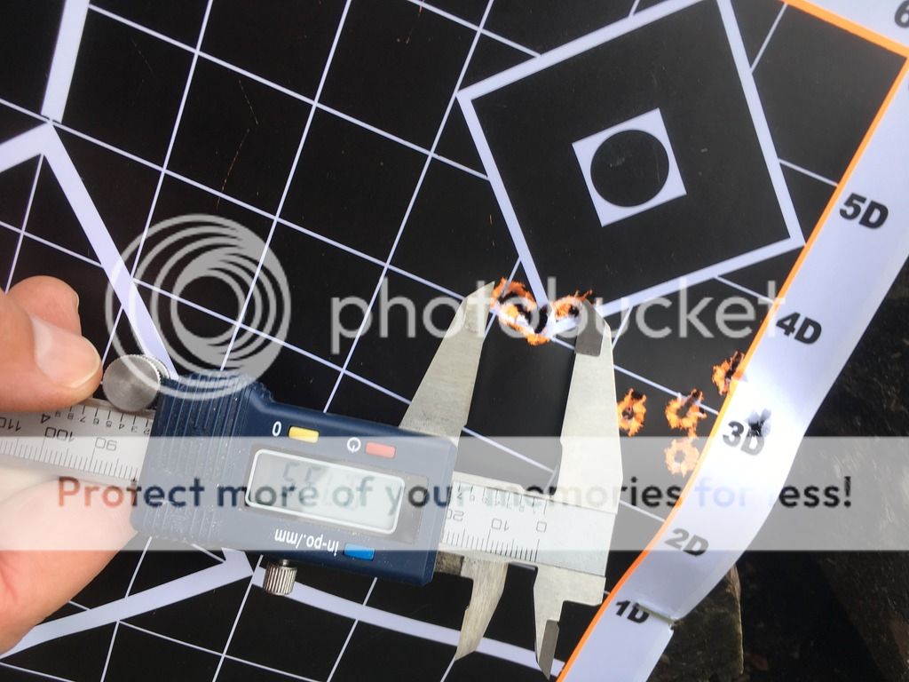

Finally had a decent day off to try it out.
So, a reminder of what I'd done so far:
-DIY bolt release mod
-DIY trigger file and polish down to 3.7 pounds
-Poly recoil buffer (cut a piece out of wife's .25 sewing needle.
-Action bedded with jbweld
-Barrel free floated
-All the innards polished
-CCI minimags chosen in similar batches of weight/rim thickness.
Well... it's a little better.
Once again, shooting 5 shot groups at 25 yards. I had 2 groups at 1/2 inch, 7 groups at 3/4 inch, and 5 groups at 1 inch.
So... now what? ^That's not terrible. If they were all half inch groups I'd be happier. So what's next? What's most likely to tighten the groups even more?
Radius the bolt?
Re crown the muzzle?
Something else?
I'm ready for my next tinkering.
