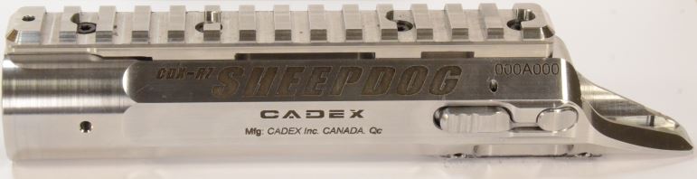

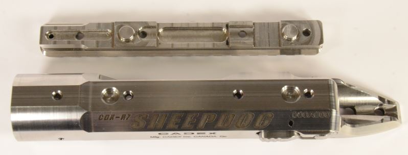

... This is why we do not offer folding stock models for the R7 Sheepdog and Shepherd.
I hope that it helps you to better understand some design technicalities....
Patrice, it makes perfect sense thank you for the detailed explanation, but this means that you catalog is misleading.
On page 16 of the new catalog at the bottom left it says "compatible with any Cadex chassis for R7 action" and it shows pictures of what appears to be light strike with top rail and folding stock and filed strike with top action rail. Yet we now know that neither folding stock nor top rail chassis are compatible.
