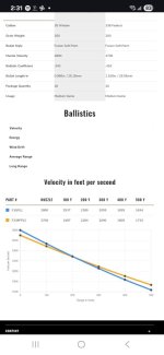

Data shown is for the smaller .338 Federal case (based on the 308 Winchester) If the data was for the larger .338-06 case, it would be different with more favorable data for the .338-06.The 338-06 does everything the 35 whelen does, except throw 35cal bullets. If throwing 35cal bullets is the goal the 338 is pure rubbish.
The 338 has the edge ballistically though - when comparing bullets of the same weight and cartridges of the came pressure the 338 will have higher velocity and more energy at range due to higher BCs. A similarly designed 225gr 35cal is simply less aerodynamic than the same 225gr in a 338cal, so even IF your 35 starts a bit faster it won't take that long for the 338 to come out on top.
Here's a visual. Even though it is starting 100fps slower, the 338 200gr fusion catches up to the 35cal at 200yds. (Note that is a 338federal load, Federal Premium doesn't list a 338-06 load)
But the 338 doesn't poke 35cal holes, nor am I aware of any cheap 338cal pistol bullets for plinking loads. If either of those are important then a Whelen makes sense.
