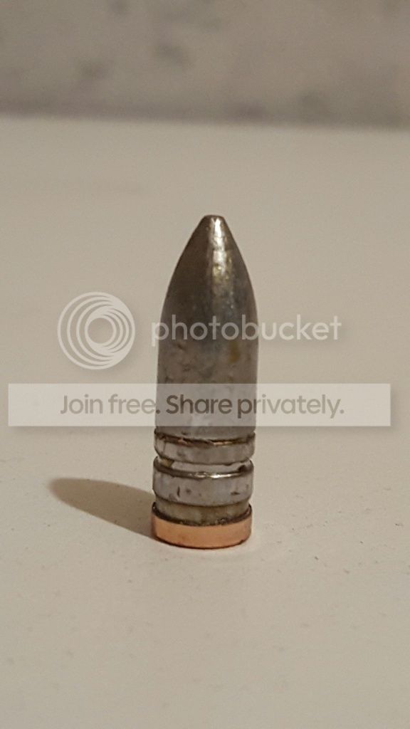

I'm using a Lee .312 diameter, 155 gr bullet under 16.5grs of Imr 4227. I then run it through a .309 sizer. I haven't shot it over the Chrony yet but there are no signs of over pressure or leading. I am heading out tomorrow and maybe I'll get a chance to measure it's speed. As far as accuracy it is the same as the 150gr campro that I also shoot. The shape of this bullet works well in my gun.

I wish that somebody like CamPro or Berrys would start making cast bullets like these ( I would buy a few thousand of each type):
These were being pushed hard by Alexander Arms at the 2015 SHOT Show but vanished without a trace from their website a few weeks ago...
