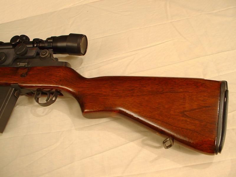

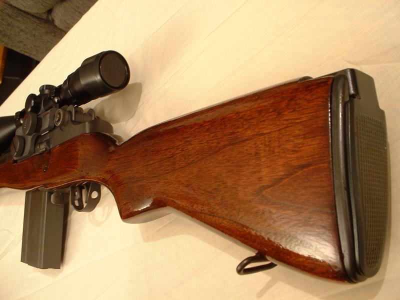

Sanding with oil is a filling technique and works very well. I use it all of the time. With very opened grain wood like the Norinco stocks, to achieve either a lustrous finsish or a satin finish many sandings (or fine steel wool) are required.
Steps
1. After stripping down to bare wood.
- Let dry for at least 24 hours (no matter how much you want to sand)
- sand with 180 wet/dry and rinse with isopropyl alcohol
- let dry for 24 hours and then soak in fresh water for 30 seconds
This is important as you want to dewhisker and get a smooth stock,
After the water bath towel it dry and let it sit for an hour. Have an iron heating up in the meantime. After an hour, place a damp towell over the stock and apply heat from the iron (1/4") over the towell. This will raise any whiskers and/or dents.
After doing the entire stock in this manner you are good to go the next day.
NEXT DAY
Usually the whiskers point south so use the steel wool to cut them off. One direction only. Don't rub, one swipe south to north depending on the grain.
Repeat this step if needed
No matter what wood I am working with I do the following after de-whiskering
light sanding with 320 and 600 grit wet/dry repeat as necessary
After this prep you can oil it and sand it for as many coats as you want.
