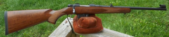

I have a CZ 527 carbine. It came in .223 and 7.62x39. Mine is a .223, I thought the flatter shooting cartridge would be generally more useful than the 7.62. It's a neat, good looking, slick little rifle, a miniature Mauser with controlled round feed. It has a single set trigger that's adjustable if you know what you're doing. I've tuned mine down to the point where I don't use the set feature anymore. Later versions had a 1-9" twist; mine is 1-12" and will shoot up to 63 gr flatbase reasonably well.
There are some disadvantages; first is that they're no longer produced, so you'll have to hunt down a used one, and hope it comes with spare mags because they're scarce as hens teeth as well ( and not cheap ).
It has good iron sights but has it's own weird scope mount set-up. It's hard to find actual low mounts for this rifle; most are high, and maybe a few medium.
The safety is backwards for an Englishman. Forward is safe, back is fire. You can train yourself to use it, but you do have to pay attention to what you're doing. Mostly I carry chamber empty, and when I do use the safety I pretend it's the hammer on a lever gun that needs to be cocked.
If you're lucky you might even find one with really nice wood.
