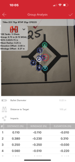

Finally had some time to work up a couple loads and found one it seems to like. So far i have settled on this. PMC brass, 75gr Hornady BTHP with 25gr CFE223 but iam sure ill try more in the future, Hoping to tighten the groups once i get some more trigger time on the rifle. My Hornady app is down at the moment but its under an inch at 100 yards
