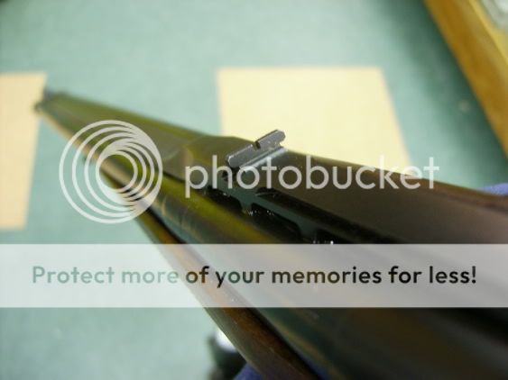

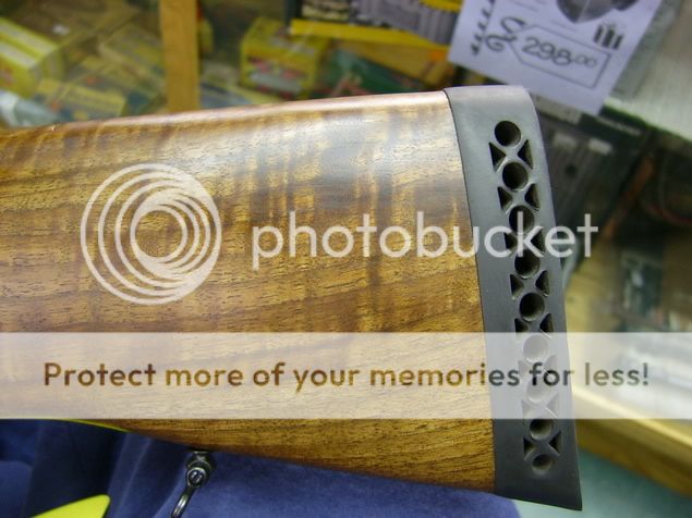

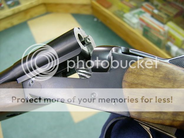

Well, I finally put my hands on a Baikal SxS rifle. It was in 30-06. The wood was nice, fit between wood and metal was good. When I first shouldered it I thought "man this has a short length of pull". But it is just due to having to really lower your face to use the open sights. Speaking of sights...they are absolutely horrid. A little rectangular slot in the rear leaf and SKS style fron post. I don't think I have ever seen worse sights in my life (on a non military rifle). The action was very stiff. There was slight rust spots on parts of the receiver. The recoil pad seemed a little too large for the stock. I didn't take it apart, so I can't say how the hidden parts look. The bluing was acceptable, but believe me, it was nothing to write home about. I guess it is a "cheap" double, so that's what one should expect. The price was $1399, an amount that I would definately not pay for that rifle. Maybe $800-900, but even then only because I'd like a double rifle.
I handled one (probably the same one). I'd hate to have to open that action in a hurry. Basically like to H & R's welded together. Wood was quite nice. I was a little surprised when I rolled the price tag over. Still, it would be a neat gun in 45-70.

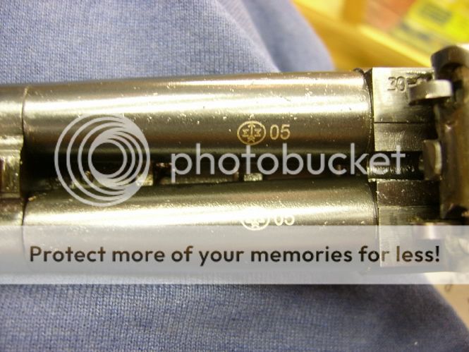

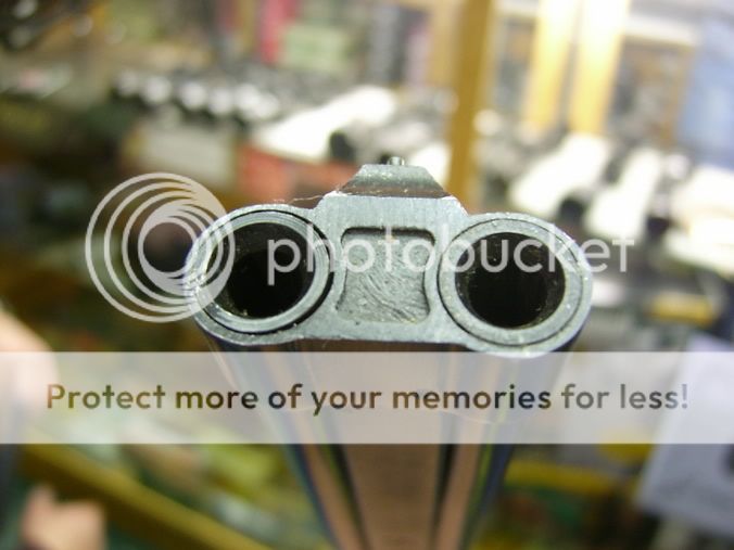

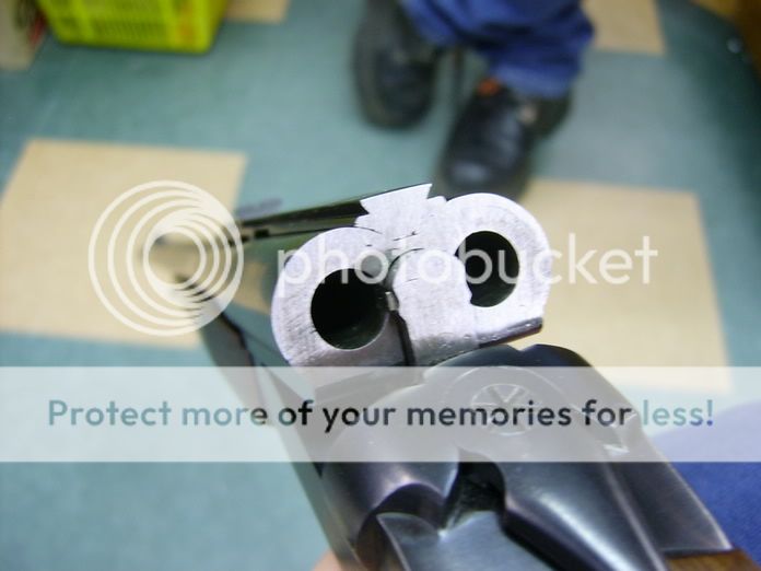

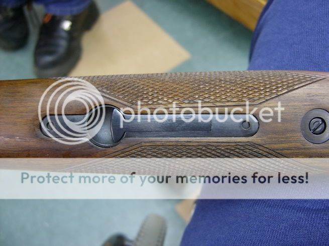

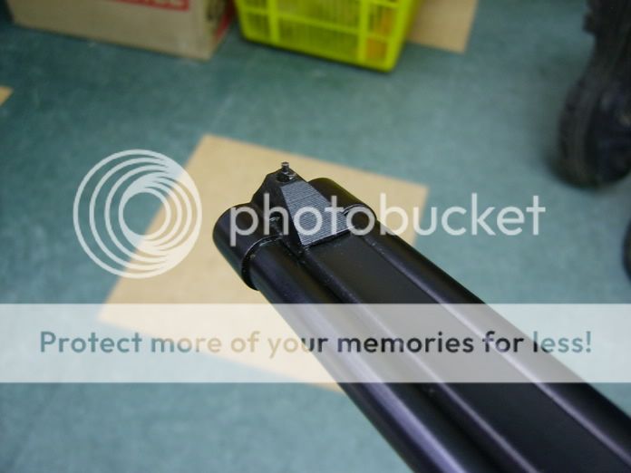

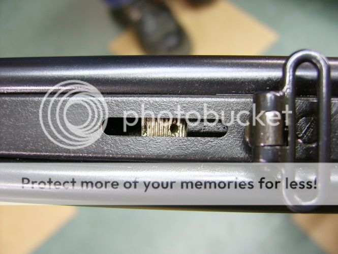

I looked at it again today, and took some pics for a fellow who is interested.

One thing realy bothers me about these guns. So far noone has said anything about regulation. It has the jack screw but what is it regulated to (or do they even attempt to regulate it?) at the factory. Judging by the position of the floated bbl in the pic it is regulated as wide as possible. Correct me if I am wrong here but hopefully it has been regulted for light bullets. As such there would be some adjustment left for heaver bullets. Heavy ones will cause it to shoot wide, requiring the shooter to move the bbls closer together.
If the gun in the pic is currently regulated for 220's shooting a lighter bullet will cause it the bbls to cross, and there is no adjustement left to go wider. You would be stuck shooting 220's because that is all that would regulate.
Also note that the rear sight is quite far to the right. Moving the floating bbl around and messing with different weight bullets will problably require a lot of side to side movement with the rear sightto get it to hit the point of aim. If that sight is all the way to the right already will there be enough adjustement left to get it to the point of aim after messing with the regulation?
