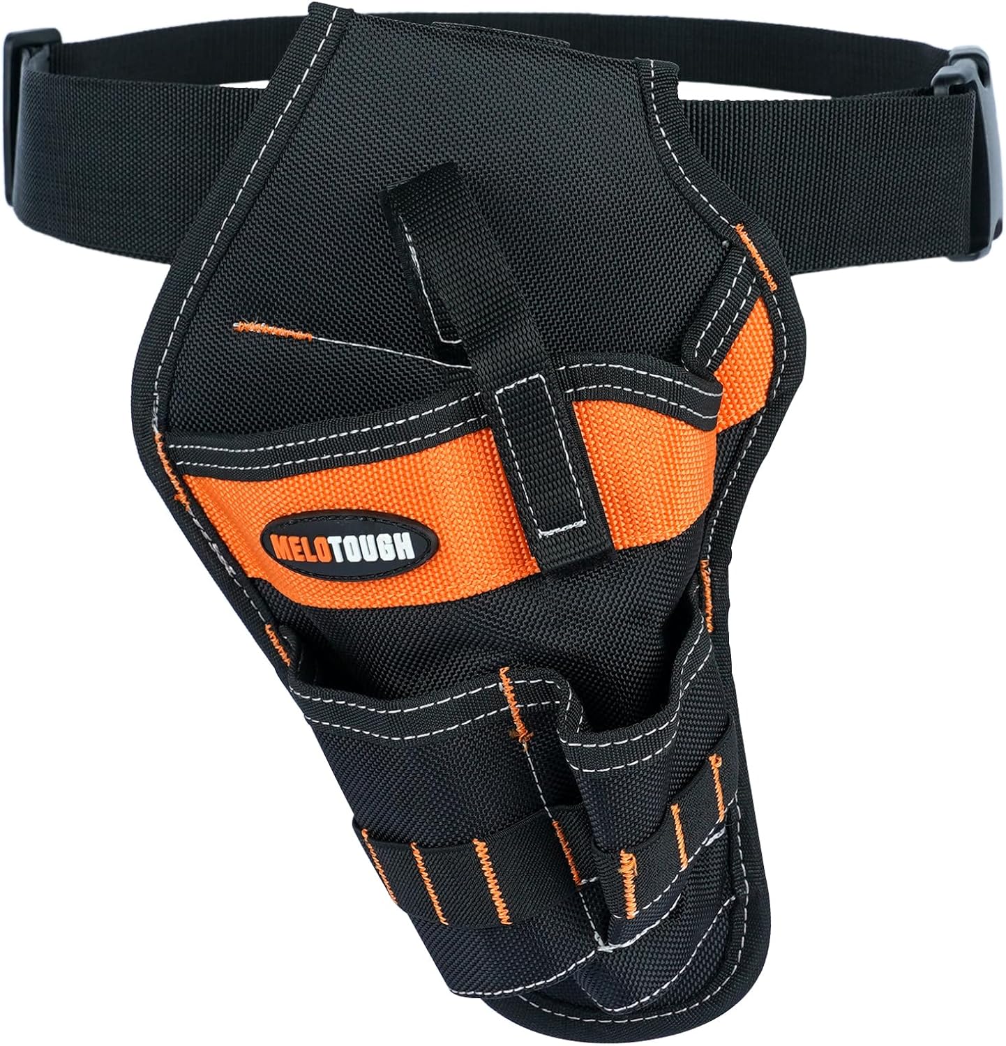

The holster works pretty good but I'd prefer to have a holster set up for a lefty and then use it cross draw with my right hand... I've looked in the past onine for an inexpensive left sided drill holster but didnt find anyting... just looked again and found this one!
It's even got some blaze orange for safety.... :)
https://www.amazon.ca/dp/B08BTP4P5X?ref=ppx_yo2ov_dt_b_fed_asin_title&th=1
