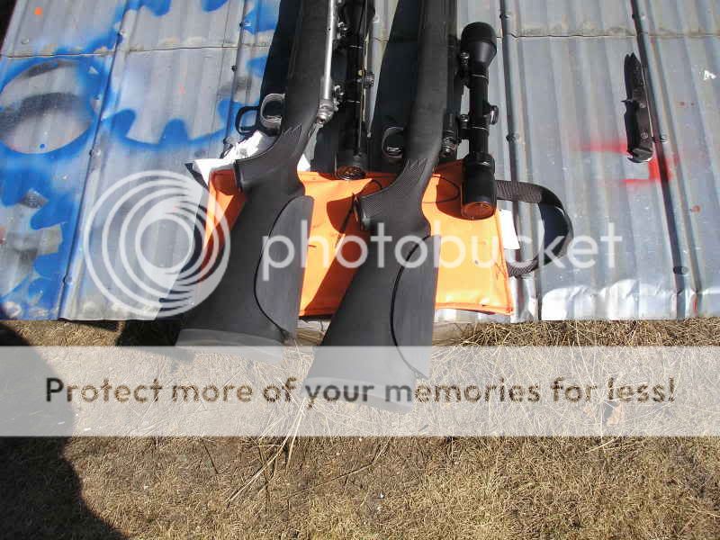

here are some pic of my bubba cheek pieces. it sure helps your shooting
when u get a good cheek weld. the 2 black ABS sewer pipe cheek piece
on my savage 44 mag and 308 FVSS. the wood stock is my ruger 10-22
target. i also cut an inch of the end of the barrel and tapered it. it only
took 3/4 pound of but it was off the muzle end and it feel like 3 lbs
less. all and all i've had a busy week. now if i just had more money!!!!!

I made a two-rod cheekrest elevator similar to yours for a target rifle. I found that the rest would collapse unexpectedly. To prevent reoccurences, I nibbled some thin veneer strips to nest between the horizontal surfaces, indexed on the rods. If a firing point is quite sloped or the back sight had to be cranked up higher than zero, I put in more spacers.
