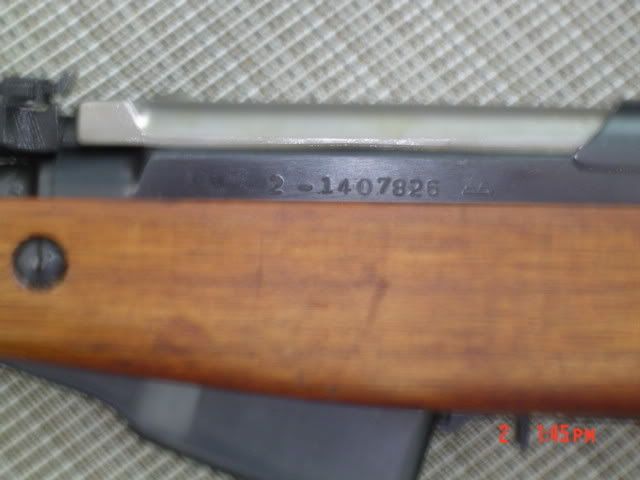

Looks exactly like the numbers in the Serial number and appears to be the same as the 2 in 7.62 though the latter is much smaller. On the same plane as well. Same size and depth of imprinting in the metal. The 7.62x39 and Made in China is much smaller (about 1/8" in height and the width of the impression in the metal is much thinner. Appears to be stamped though not pencil engraved. Do you think the importer also stamped the stock with the serial number as well?

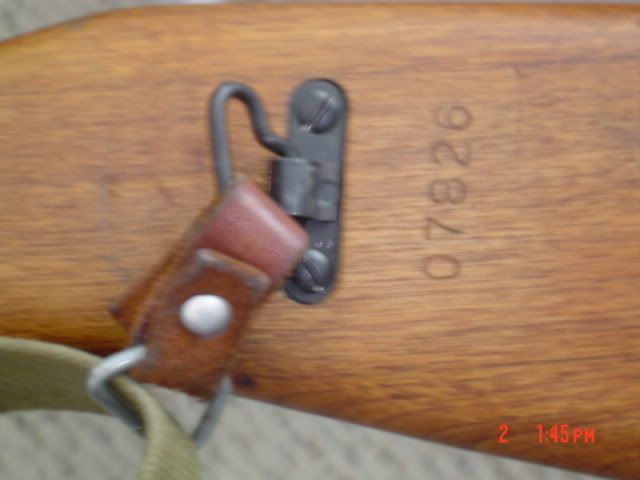

My serial number is 2 - 1407826. The 07826 is stamped on the stock as well as the bottom of the trigger guard which is machined.

Here are the pics of the serial number and stock

That's not a Sino-Soviet, Bob. The factory marking should be a 26 in a triangle and the serial # should be a letter followed by four digits.
Can you make out what the stylized number in the triangle is? This page may help you with the factory code.
Same factory as mine, except mine has an F in the serial number the the sling swivel is on the bottom of the stock instead of the side and my bolt carrier is mirror polished.
From the diagrams I would say it is 0406
well, im disappointed . factory 0406 is not sino soviet.
i guess you didnt see the factory list when you told us it was a factory 26.
Suspect the blade was replaced. My serial number is 2 - 1407### followed by the Factory 26 symbol. No Chinese characters other than what is inside the triangle.

0406 alright. Not a Sino Soviet. The basic Sino Soviet will have a letter followed by 4 digits. Russian firing, accuracy and cyrillic inspector proofs will be found on T56s using Russian parts.
