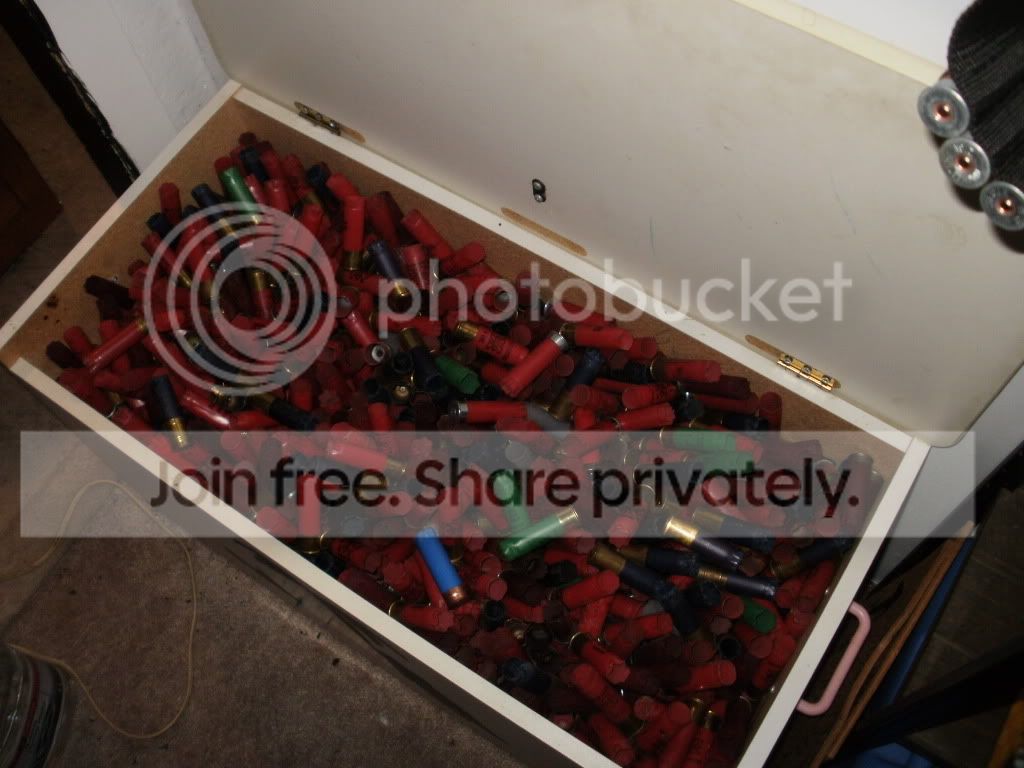

i like the older red AA hulls for reloading since they seem to be esier to size, and last longer i have some that are on their 16'th reload, while i have had some only last about 8 reloads before they crack or break. but i do use anything i can get my hands on. they all work, some may size or load better than other but at the end of the day it is just a shotgun, not a precion rifle.my other favorites are the winchester/federal low base target rounds from the cheap bulkpacks of 100rounds, dominion high brass, and winchester high brass hulls last year i brought out a 5gal pail full of homeload slugs and i only had a few get stuck in the chamber ith the bulkpack hulls. birdshot usualy is pretty expensive now, so i would sugest maybe trying to talk someone into a good deal for a few bags to make it worth it. for my loading i like to use 33.5gr of HS6 powder for all my birdshot and slugs/roundballs.
heres a photo os some of my hulls that i like using...
