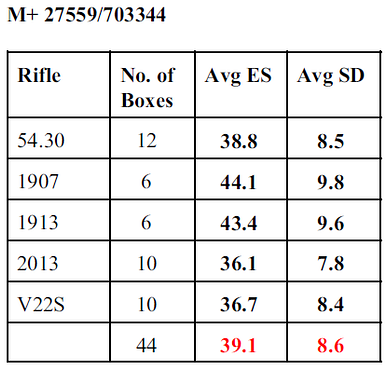

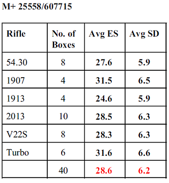

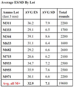

The crucial point is that all lots will have a range of ES/SD. Many shooters may be surpised by how much ES/SD varies within lots. Below are examples from the ammo I tested that give an idea of ES/SD variation within the lot.
This chart shows the rifles that shot with this lot. It shows the number of boxes each rifle used. It also shows the average ES of all boxes and the average SD. What’s worth noting here is that not all boxes are the same. The chart shows the lowest ES and SD per box for each rifle and the same for SD.
This was a more stable lot of Midas ammo. Below is one that’s less stable. The ES/SD varies much more. Low ES and SD in the 20s and low 5s, respectively. On the high side we see ES figures for some boxes a little over 50 fps and double digit SDs.

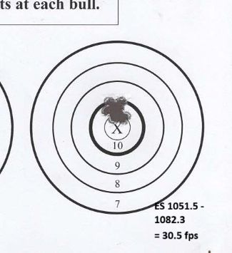

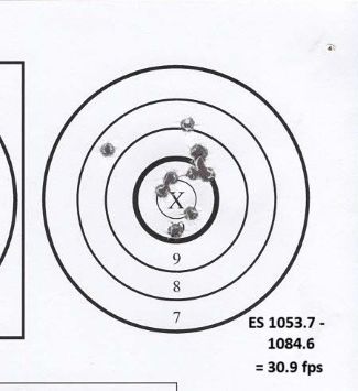

Does ES predict POI – An example
Here’s a simple exaple that helps illustrate the inconsistent relationship between a round’s MV and POI. Below are two ten-shot groups at 100 yards. They were shot with the same lot of Midas, the same rifle, on the same day. Both ten-shot groups have virtually identical ES.
If ES explained group size, these two groups would match. They don’t.
This is not a one-off example. This happens regularly and is not unusual. It can be expected to happen. Why? MV (and ES/SD) don’t consistently predict were a round will impact. MV simply doesn’t consistently explain POI.
To repeat a point, low ES and low SD don’t guarantee how ammo will perform.

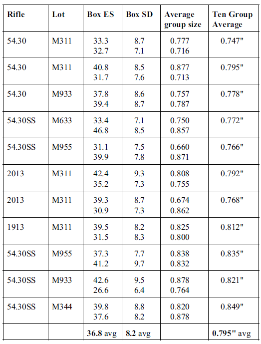

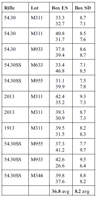

Consider the chronograph data shown below. For each of the nine examples the ES/SD numbers for two boxes are shown. The boxes were from the same lot and shot consecutively with the same rifle.
The eleven examples show four different rifles shooting five different lots of Midas.
These boxes have higher than average ES and/or SD, averaging 36.8 and 7.1 fps, respectively. The average ES for all lots was 32.9 and average SD was 7.1 fps.
What kind of performance did this at best “ordinary” Midas ammo produce?
Is Ammo with Poor to Mediocre ES/SD Destined to do Poorly?
Below is a chart showing how the mediocre ammo actually performed.
Seven of the eleven examples produced 100 yard ten-shot group averages under 0.800". By most standards, that is very good for .22LR.
Four were between 0.800" and 0.850". That’s still very good. All were much better than the overall average of any lot.
Ordinary MV and SD numbers but still great accuracy.

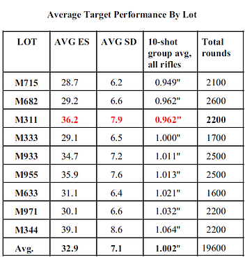

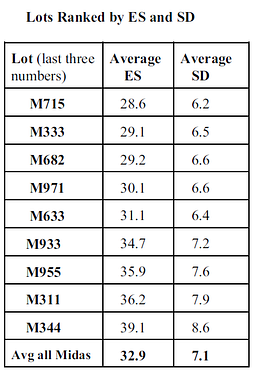

Will a Chronograph Identify the Best Lots?
A common idea is that by comparing ES/SD between lots you can pic the best one.
Sometimes this may work out. But does it work as a consistent rule?
The best chrony numbers are not necessarily consistent with the best performance on target.
The first chart shows how the chronograph would rank the nine lots of Midas. The next one shows how the targets actually rank them.
Midas lot M311 ranked low by chrony values alone. By target evaluation, it's a very good lot. Very mediocre chrony numbers yet very good target results.
The conclusion is obvious. If chronograph numbers correctly ranked lots, this result would be impossible. But it happened.

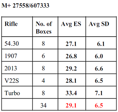

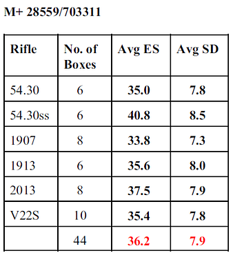

Do Rifles change ES/SD?
Does ES/SD of a lotdepnd on the rifle doing the shooting? Will different rifles give very different ES/SD values with the same lot?
With limited testing it will be impossible to know. Since the same boxes of any ammo can only be tested once, those boxes cant be compared with different rifles. We know that different boxes from the same lot will have differences in ES/SD. It’s normal and expected.

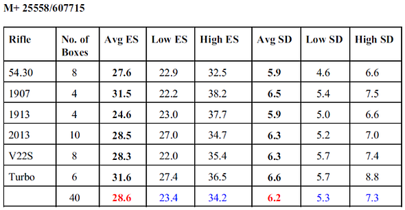

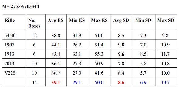

With large samples its’ possible to determine if ES/SD is rifle-dependent.
Below are charts showing different lots tested and ES/SD variation by rifle.
There are differences between rifles, but they are generally small:
• SD differences of about 1-3 fps
• ES differences of about 5-15 fps
But the important point is this:
The rifle influences ES/SD slightly. The ammo determines it overwhelmingly.
