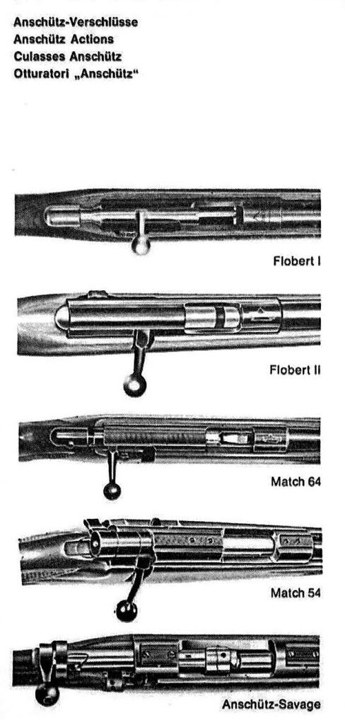

If it is, it doesn't look like it is related to Anschutz. The CIL Anschutz 125 (same as Anschutz 1400) uses the Flobert II action, while the CIL Anschutz 180 uses the 64 action. The Anschutz actions are shown in the following image, from a bird's eye view
