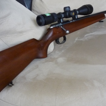

I recently bought my first CIL Anschutz . It's a model 180 which currently wears a peep sight . Took out first time today and am considering mounting a scope on it . Just wondering as to whether or not I will have to put taller scope mounts on to clear the large front sight . And with all the current model .22 LR specific rim fire scopes available , what models are the most used for this gun . Don't really want to spend more than $250 CDN as I also have to re-scope my Marlin 25 MN .22 mag . It currently has a older 4x , which seems to be lacking when it comes to seeing the bulls eye at 50 yards (fine cross hairs cover the bull ) . The CIL will be used for squirrel hunting and plinking at 50 yards . Maybe a Nikon P Rim fire or is that much scope necessary in the bush ? Not really interested in fixed powers or parallax adjustments .

I also have a CIL 180. I installed a Nikon target EFR 3-9x40 with adjustable objective. It can focus from 10 yards to 300+.

Burris deluxe steel rings (high height) works well. Fits the 11mm dovetail and the CZ American too. Just enough clearance for 40mm objective. Got it from Wholesale Sports.

Don't worry about it. You won't see it. I've had the CIL Anschutz 180 scoped and you just don't see the front sight.
