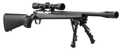

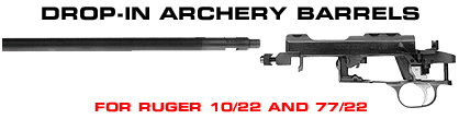

These new rimfire products are based on Ruger rimfire rifles; the Ruger 10/22 and the Ruger 77/22 . The standard . 22 barrel is removed from the Ruger rifle and an Airrow barrel developed strictly for launching arrows or tranquilizers is substituted. Standard Ruger stocks require inletting for the .920” diameter Airrow barrel. Once the new Airrow barrel is installed, standard .22 caliber ammunition of any description can NO LONGER BE FIRED through the rifle. The firearm can only be used for firing blanks which will power arrows or tranquilizers. The Ruger 10/22 and 77/22 are easily converted back to their original rifled barrel for standard .22 caliber ammunition use. Ruger’s Wedge Lock Barrel design allows barrel to receiver changes in just minutes using only a 5/32” allen wrench.
The arrows used in these products are #2512 and 16” in length. Using 75 grain target points the total arrow weight is 305 grains. They feature a hollow aluminum shaft, with the back of each shaft left open, immediately behind the fletching for installation to the barrel.
The barrel used in these AIRROW rifles consists of two barrels: an outer barrel (shroud) with an outside diameter of .920” and a second floating inner barrel. The inner barrel fits inside the hollow shaft of the 2512 arrow. The fletching must roll over to fit inside the outer barrel (shroud) and the shooter is advised to use a rotating clock-wise motion as he first fits the arrow to the inner barrel and then pushes it down inside the outer barrel (shroud).
