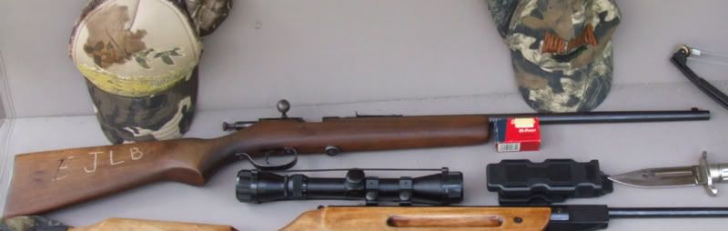

Looks nice :cool: , try and find some good blue, this stuff will work well
