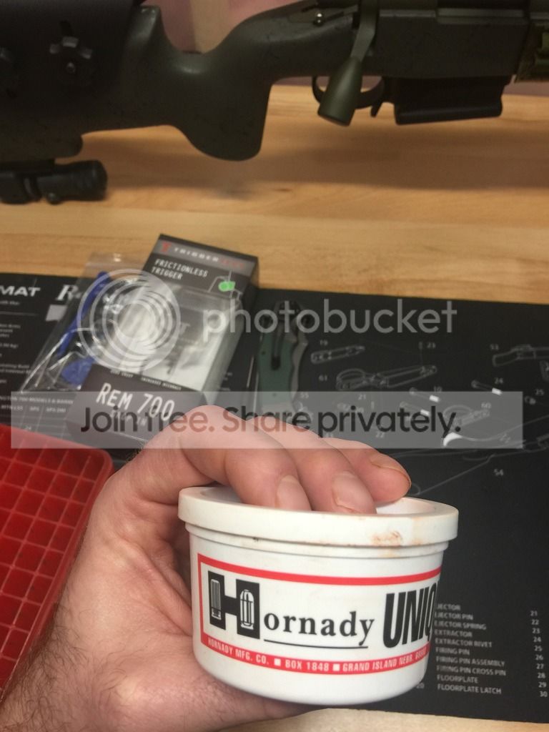

Maybe this case wax is the problem ?
NO the Hornady Unique is not the problem and any type oily case lube other than dry graphite powder will let the polishing compound stick to it. And I use Hornady Unique all the time if not using my home made alcohol and lanolin mix, and its a good case lube to apply by hand, just using a finger.
Hornady Unique contains by the MSDS,
Mink Oil 5-15 %
Glycerol Monooleate 5-15 %
Bleached Tallow 70-90 %
Refined Paraffin Wax 0-5 %
Bottom line, the vibratory tumbler is shaking the polishing compound off the walnut granules and it ends up inside the cases. Either live with it or switch to untreated walnut media like found in pet stores for lizard bedding. And the Jerry Miculek video I posted he even tells you he even washes his "untreated" walnut media to get more usage out of it.

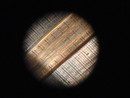

And the Savage button rifled bore below could use a little "polishing".
Below a Savage barrel after fire lapping
So if you do not have a custom hand lapped barrel you paid a arm and a leg for don't worry about a little polishing compound in your bore.

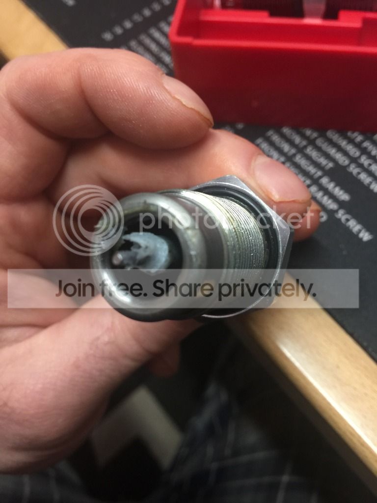

And guess what media is in my vibratory tumbler. Sorry it was faster to copy your image than take a photo of my same container. A Redding .243 die body spent the night in my tumbler a few days ago to polish the die slicker than snot on a door knob. ;)

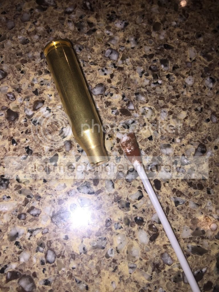

Just looked under the resizing die and it accumulates there quite a bit maybe I should go back to a spray can lube , don't seem like I had clumping and flaking of tumble media coming out cases before
The brass on the outside gets very nice and clean but look how dirty the ID of the shoulder gets

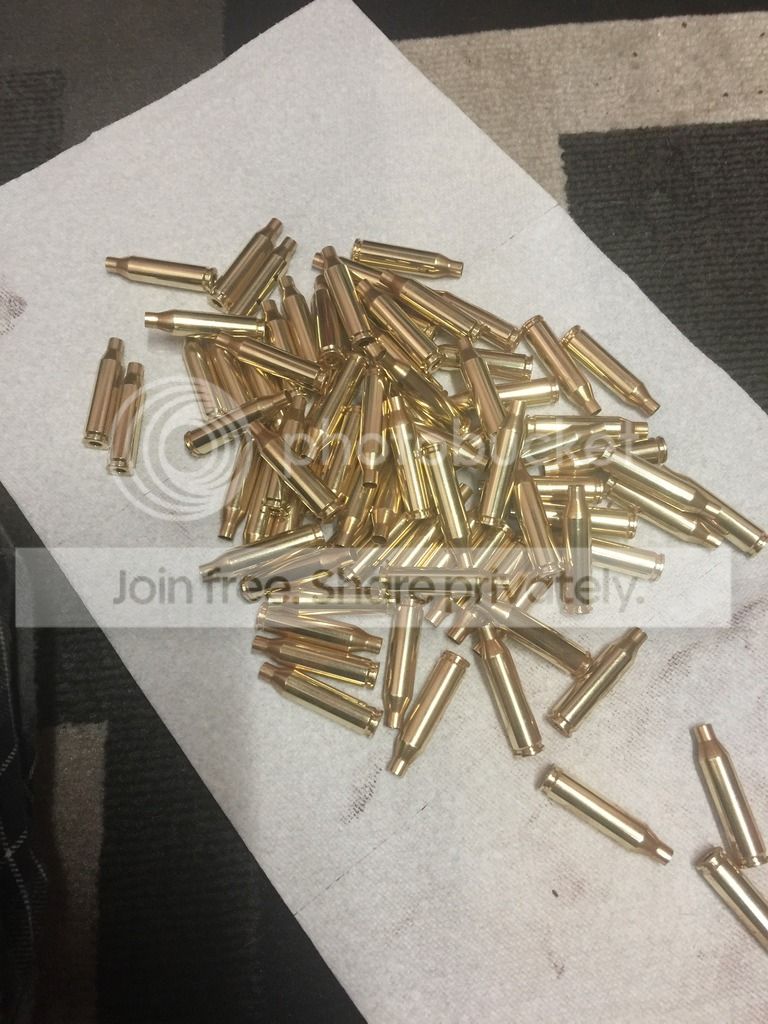

You are correct, cleaning is 100% cosmetic. As is almost every other cleaning chore done by humans.
With that settled...I can't go through the whole reloading process and wind up with sh!tty looking ammo at the end. So I sonic clean then tumble in rcbs media.
