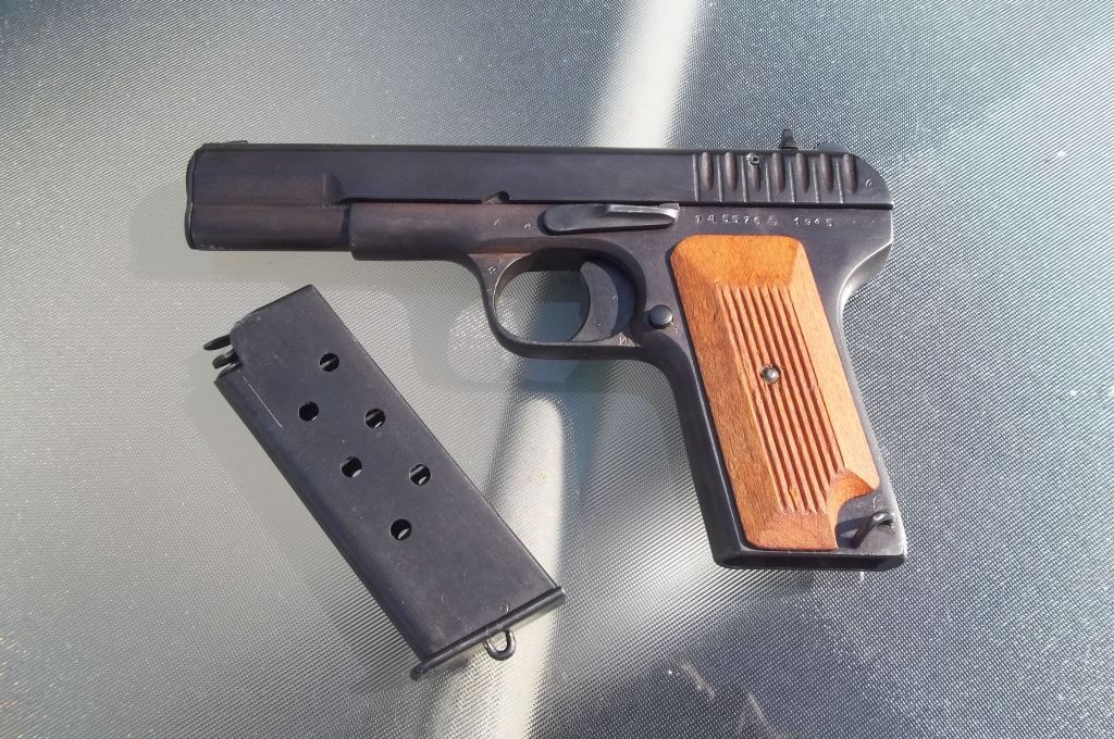

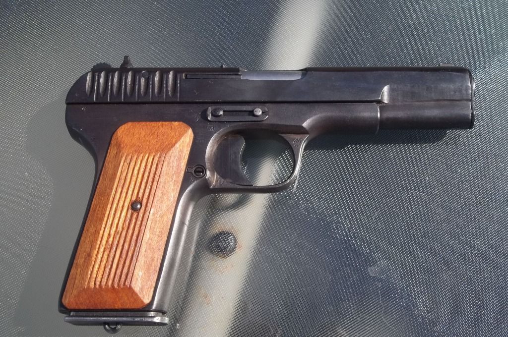

heres mine from Trade Ex, i bought few weeks ago
dated 1945, it came with wooden grips but im not sure if they are the original.
Yuck. Those are NOT original WW2 grips.
Looks like very recent manufacture from beech (not birch like they should be) and of the totally wrong pattern.
