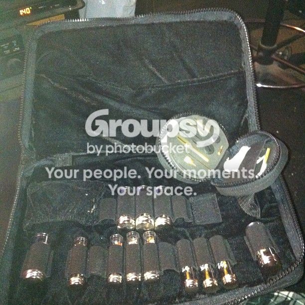

I bought the Otis system with all the cals. available.It was a little pricey but I cant remember where i got it from.Good for everything from .17 to 10 gauge.
Heres the one : ht tp://www.otistec.com/pc_product_detail.asp?key=42C53F70C0A941A2B942452A4E83C9CF
Its the Otis Elite® Cleaning System
