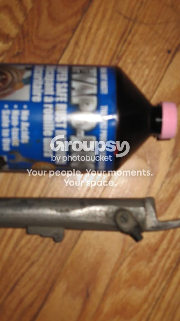

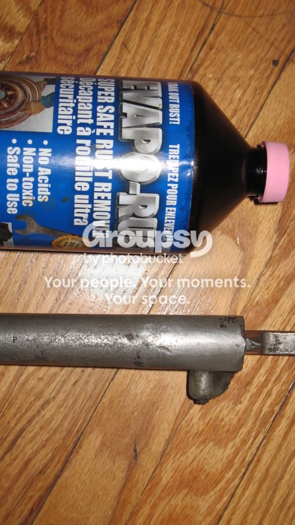

Finally tried this stuff...WHAMMO..:eek: rust just fell off, no smell no poisonous vapors no burning hands or acids and ZERO scrubbing, this stuff is heads and shoulders above naval jelly and hours of scrubbing.

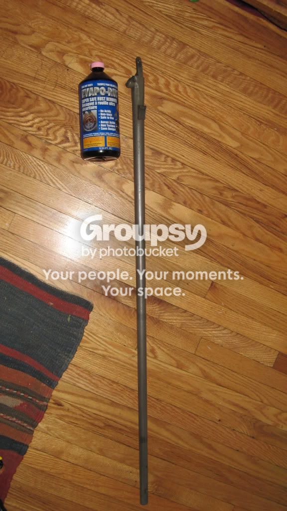

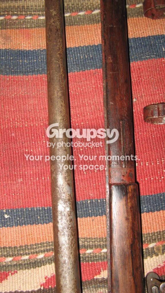

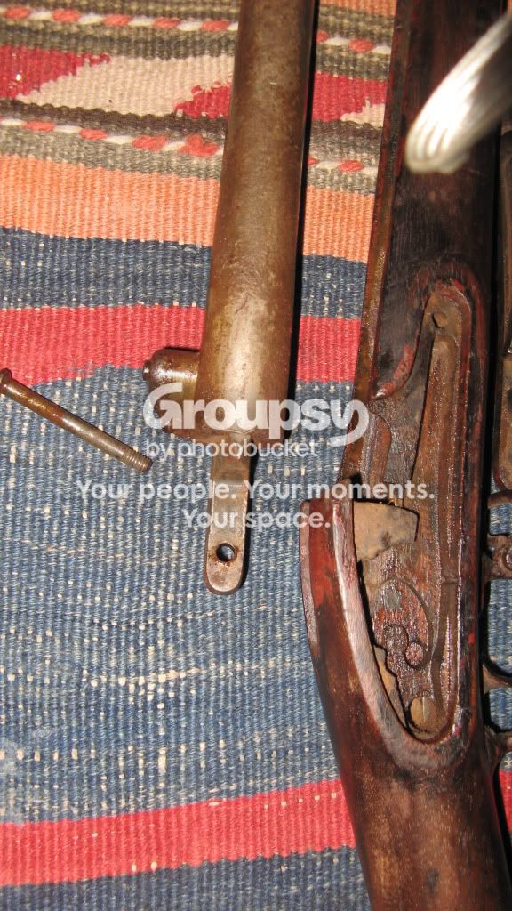

I made a trough, laid the rusty barrel in it, went to bed, the next morning I pulled it out and TAAA DAAA:eek: a clean barrel,
the bore is really good aswell only a couple little pin tip pits.
The metal comes out dull and needing a little polishing.
The rust just falls away, no smell no toxins....its just great..
