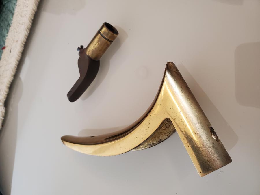

I found some pics of brass with a coating on it. These parts are from a 1980 Browning Mountain Rifle. I tried to polish the tarnish out and my most abrasive cream polish wouldn't do anything. On closer inspection, I found that it had a clear coating on it and looked like ass. I sanded it off with a very fine foam sanding block then polished with polish applied to a microfiber rag taped to the same foam block.

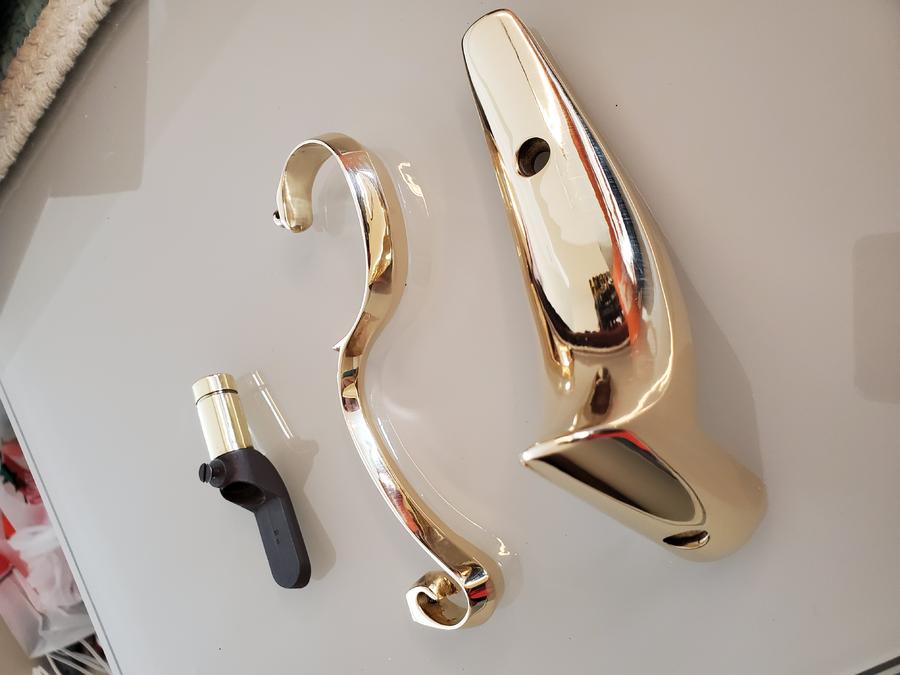

How dare you disrespect the thread you started by not posting the "after" photos.
Good point. Crappy pic as I'm a bit pushed this morning. But those marks are basically gone. I'll do the final touches tonight. Good quick response from Henry. as well.
