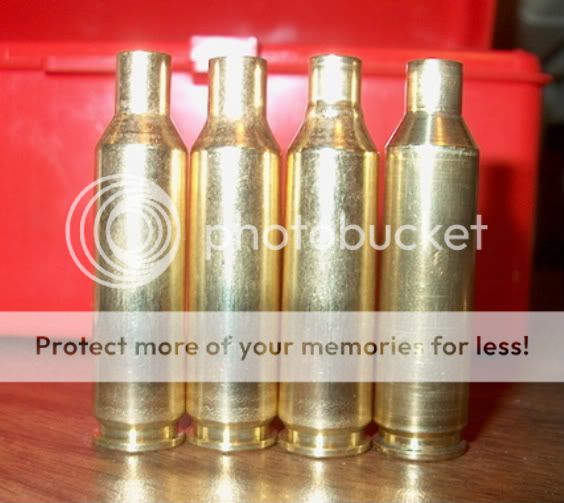

Here's the final product. Used my cut-off 308 SB die to size the base down (you can see the darker area of that is sized down, about 1/2 way down the case to the base and this eliminated the "click"), then a 260 mandrel to neck it, then thru a 6BR die to set the false shoulder. The last case is a formed 308 Lapua case also made into 6-250 since I have not fire formed any of the 6XC cases yet. Using the 6XC as a parent, there is a lot less work in making the 6-250 30 degree shoulder case. My case is a hair longer than the 6XC and has a smaller base size, otherwise, it is the same case.
