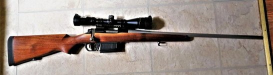

I have a Sav-12 with the 'flush-fit' mag and I find it difficult to open and close. I have a Rem 722 that was 're-built' with an aftermarket Drop-mag that will accept AICS mags and I find it quite functional. You'd have to check to see if these are 'user-install' or would need a gunsmith to make it work if you tried it.
Yea I would go for that but this is a backpacking rifle that I use for mountain hunting like the kind of hunts where every ounce really matters. Maybe I can find something a little lighter but similar to that.
Nice looking rifles!

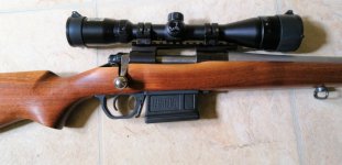

Yes, the repl assy is all heavy plastic, but not 'that heavy' - not metal hardly anywhere, and so are the mags. Here's closer shot of the drop-mag on the 722. It's a 1960 model.
And there are mags with only 3-shots that are more flush - this one is a 5-shot. The repl assy with one mag runs about $150 or so. MagPul that are made for many rifles, I believe. I don't know if this would fit in your Stockys easily, depends on if You are handy with a Dremel :rolleyes:
